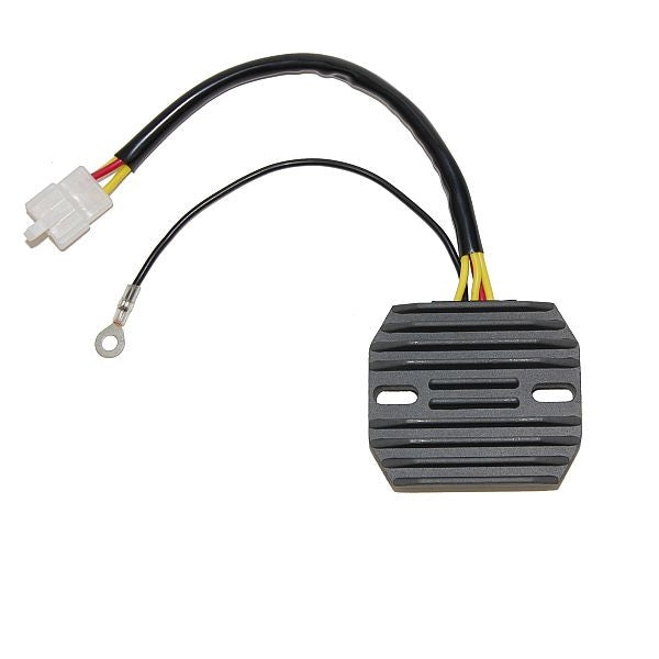

      It does have a one year warranty too, so I guess I'll try it. The R/R I am planning on was this one from Electrosport, which one do you recommend and who sells it?
      New Electrosport Regulator Rectifier Direct Plug In Replacement, 1 year warranty, plug and play ESR090 Regulator/Rectifier Suzuki GS series

            • pistolpete
              When my rr went bad on my bike i bought an electrosport rr. I installed it and it was charging at over 20volts. so after double checking everything and going through the stator papers it led me back to the rr. I tried to call the company just kept getting voicemail, no call backs. I e-mailed the company and no e-mails back. so pretty much a waste of 100$ I think i've heard some people here have good luck with electrosport but this was my experience with them.
              • TPL
                Thanks for the advice, good to know.
