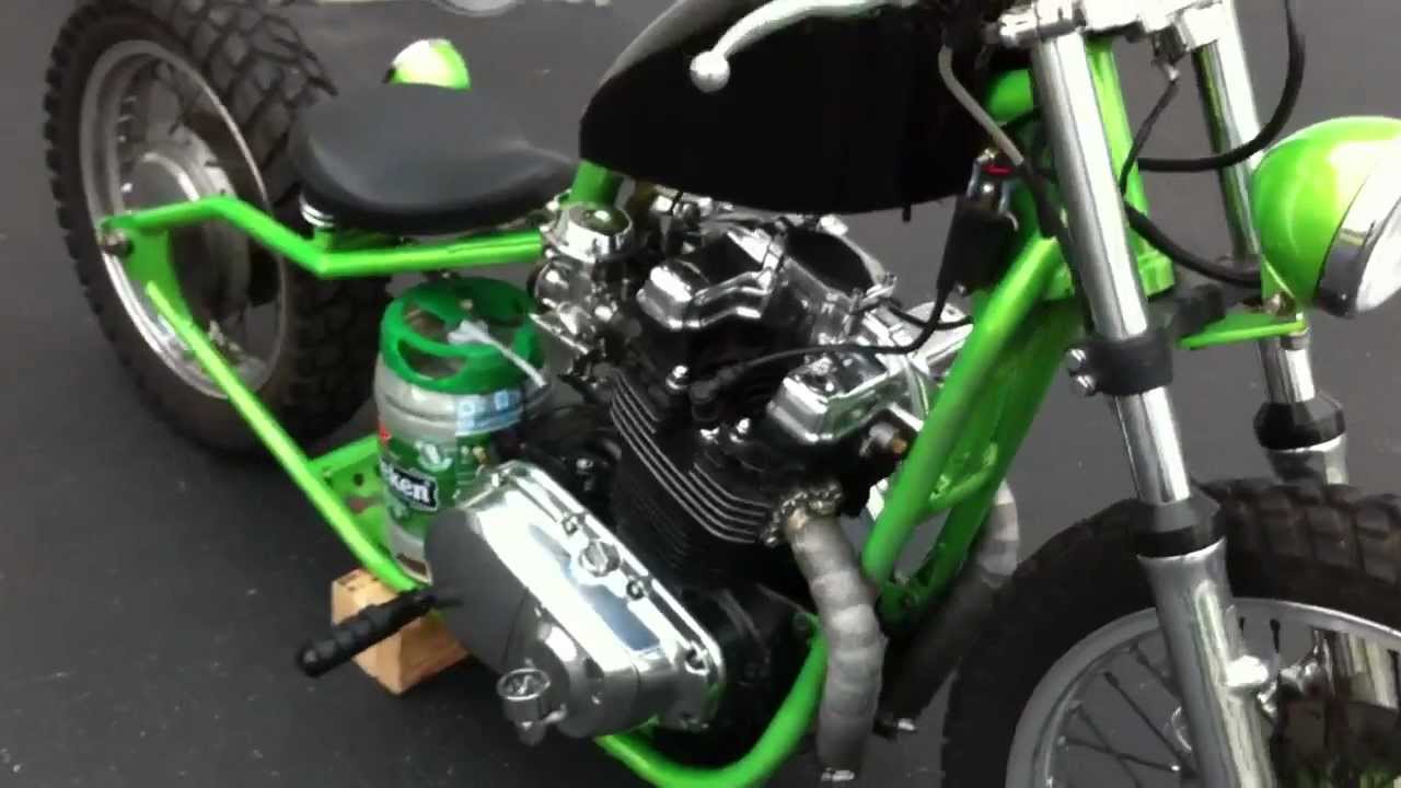

    Hey guys just looking for some info. My starter relay/solenoid failed im just wondering if this bypassable. my 81 GS650GL is pretty modified and hacked as it is its a bobber/ratbike. Im just curios if I can bypass the relay with a mounted push button toggle, rather then going and buying a new relay. Also i think it would be another neat little feature to add to the bobber/rat look having a secret little button to start it. Is there any damage to the charging system that can accure from a bypass. Im not concerned about losing saftey switches and No one rides it buthave mods that eliminated some safty switches. Any info is appreciated.

      Actually the only safty thats really been bypassed is the safty so you cant start in gear. I dont remeber why i think it was when I removed all the gauges, blinkers, and such fabbed a bracket and remounted the speedo. Ive had my bike for like 6 years so i cant remeber exactly. I know I will get ripped on for these things but i enjoy my bike the way it is. Ill see if i have a pic i can add, im sure your thinking all hacked and exposed and ghetto. I actually spent alot of time painting fabbing and making things look good. Yet leaving little things simple to make it look kinda ratish.
