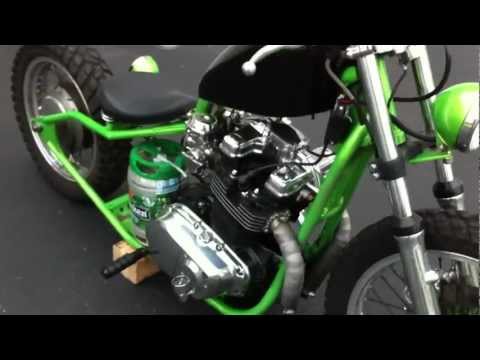

                Found this earlier today while discussing a GR650. It's one of the best starter ideas I've seen for a while.
