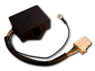

          This site makes a new one if you don't want to buy a vintage used box, and it's nearly the same price as the used ones. They call it a CDI but I trust it's a transistorized ignitor, or at least works in a substantially similar way.
          High-quality Digital Suzuki GS450 CDI Unit. This is a direct replacement to your original unit plug-and-play connectors. Our Digital replacement is a direct fit for easy installation. High-quality custom circuit boards and that exceeds the previous OEM equipment are used in production. All products shipped are made to

            This site makes a new one if you don't want to buy a vintage used ignitor box.
            https://www.regulatorrectifier.com/c...gs450-cdi-unit
            Considering the ignition is not a CDI that site doesn't exactly inspire confidence.

              But, on the other hand, it looks like a TCI ignitor and not a cdi. Probably this seller-site has labelled it as a "CDI".
