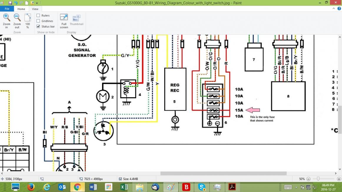

    I have a similar problem as posted by Bearjew:
    Originally Posted by Bearjew
    Ok. I found the issue? I was outside testing the wires, cables, fuses etc. And noticed power in second fuse from the bottom but nonever coming out. While testing my fuse ends I touched my tester end to the fuse from the wire and everything lit up. It appears that either the holder was loose or when the fuse blew it loosened the holder? I don't know but I took some pliers and tightened everything up a little and everything is good again. So it blew two fuses and the connection was loose. Thanks for all the help guys.
    Hi there
    This is the closest I could get to the issue I am dealing with. In short - the electricals on the bike just quit. When I turn the ignition key to on - there is nothing. Battery is fine. There is current in the 2nd fuse from the bottom - but in none of the other fuses. When I bridge the solenoid the engine turns over.
    I do not have the fuse as show in the picture posted by Bearjew.
    Is there anything I can check? I am a 1st time wrencher - so any help will be greatly appreciated, but please make the advice as detailed as possible. I feel that it should be something that connects or is common to the top 3 fuses but just cannot fathom what it could be from the wiring diagram.
    I have checked that I have the correct wiring diagram.

          First off you want to verify you have battery voltage at both sides of the 15 amp main fuse. The second one from the bottom. Then you want to verify that you have voltage when the ignition switch is turned on. That should provide juice to the right side of the top three fuses. If no juice then your problem is between the main fuse, ignition switch and return path to the fuse box. If you have voltage on the right side of the three top fuses with the ignition on, then check the left side of the top three fuses. If you have no lights or ignition, then the problem is most likely before there or a main connector that's come apart under the gas tank.
          Hi
          I have tested the left and right side of the fuse box. Here is my finding
          What does it indicate if there is a reading on one side of the main fuse only?

                  First off, let's get the terminology correct. You're measuring voltage, not current. That's what you should be measuring.
                  If you don't have 12V on the red wire going to the ignition switch then the problem is between the fuse box and the switch wires. If you have +12V at the output of the main fuse but no voltage at the switch, then you have an open in the harness or at the fuse box. Check the fuse box red output wire and follow it to a bullet connector. There should be 12V there. If not, then your problem is within the fuse box. If you have voltage at that connector, then verify you have it on both sides of the bullet connector. If not then there you go. If so, then follow the ignition switch wires back to the harness. There's a connector there. Verify you have voltage on both sides of the red wire of that connector. Disconnect the connector and verify that it's clean and well connected. High resistance from corrosion generates a lot of heat and tends to melt the connector in the process.
                    Seems to show that have power comming in (the bigger red wire) to the fuse block and going to both the aux fuse (bottom) and the Mainfuse (next to bottom). And have power going out the aux fuse, and do not have power going out the Main fuse... like the main fuse is blown open or is a bad connection inside the fuse block at the main fuse. Pull the main fuse and check that fuse itself with the ohm/resistance/continuity setting. SHould read the same as touching the two meter leads together. If reads the same as holding the leads apart, that is the fuse is blown/burnt/melted open.
                    (should have added your voltage notes on opposite sides of the diagram, the red wire on the right of the diagram is the power comming in to both main and aux fuse, the red wire on left is the wire out from the main fuse going to the ignition swtich). The aux fus poweres the screw terminals on the bottom of the fuse block.

                      Anyway, so we now, with your voltage reading notes, we have found that the problem is that you don't have main fuse power.
                      So, lets go back to previous post. .....
                      Check the main fuse.
                      Note: The main fuse is the 4th one down, next to the last one. SHould be a 15 amp (all others should be 10s).
                      And maybe getting ahead of you here, but if main fuse is bad, and you replace it, and it blows immeadiatly even with ignition key is off..... then that is probably a bad R/R, try unplugging the R/R and replace the main fuse again.
                      If your 15 amp fuse is blown, and you dont have a 15amp spare, you can do like Steve said, pull the aux fuse and use that in the Main postition, and, I will add, you could also pull the 10 amp headlight fuse, then the 10amp in the main will survive longer. Again, this is just a test, and to get the bike running again. If you do want to go down the road, yah, put the headlight fuse back but dont use high beam and dont use turnsignals and dont use horn to try to keep from overloading the 10amp main fuse that should be a 15 amp.
                      If you dont have anything connnected to the screw ternimals on the bottom of the fuse block, then there is no need for the 10amp Aux fuse, just concider it to be a spare.
