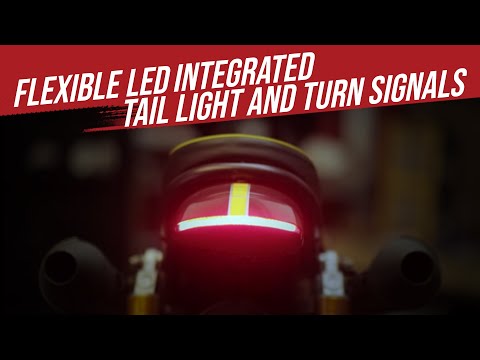

                            I'm guessing this is what he has.
                            QUICK OVERVIEW
                            12 Volt Super Bright 5050 LED Chips
                            High quality plastic construction
                            Lightweight and waterproof
                            Includes 3M Adhesive Strip
                            Red Brake and Running Lights
                            Amber Turn Signal Indicators
                            Length: 8"
                            Width: 0.5"
                            Wire Length: 38.25"
                            Wiring Guide:
                            Black = Ground
                            White = Running
                            Red = Brake
                            Green = Signal
                            Yellow = Signal
