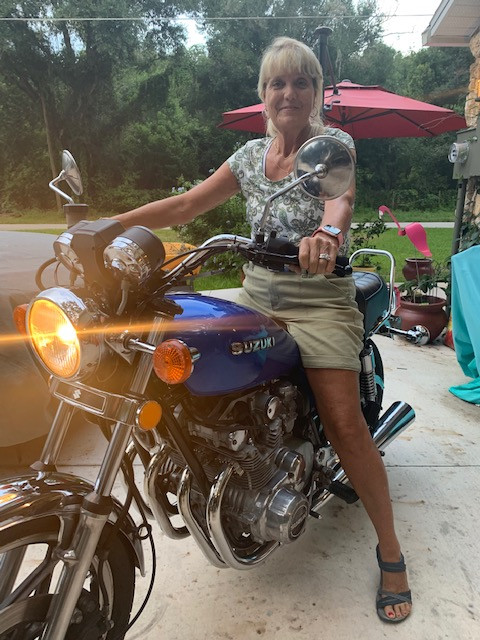

      Whoops! The bike that got the Dyna is a 1981 GS550L. One of Lesa's bikes.
