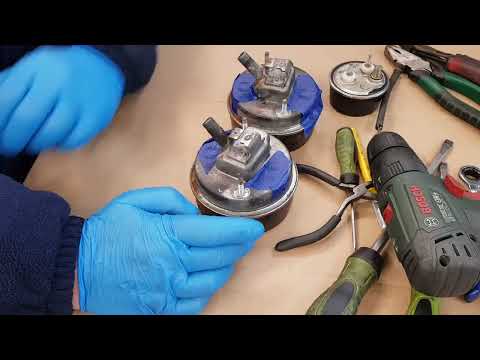

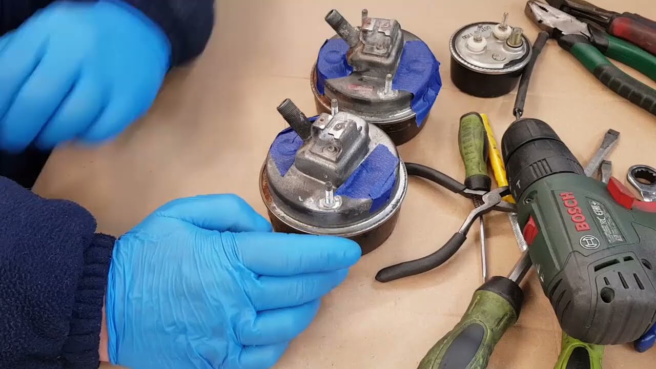

    Easy way to test is unhook the cable from the wheel, and use a drill to see if that tells you anything.
    Check like halfway this vid.
