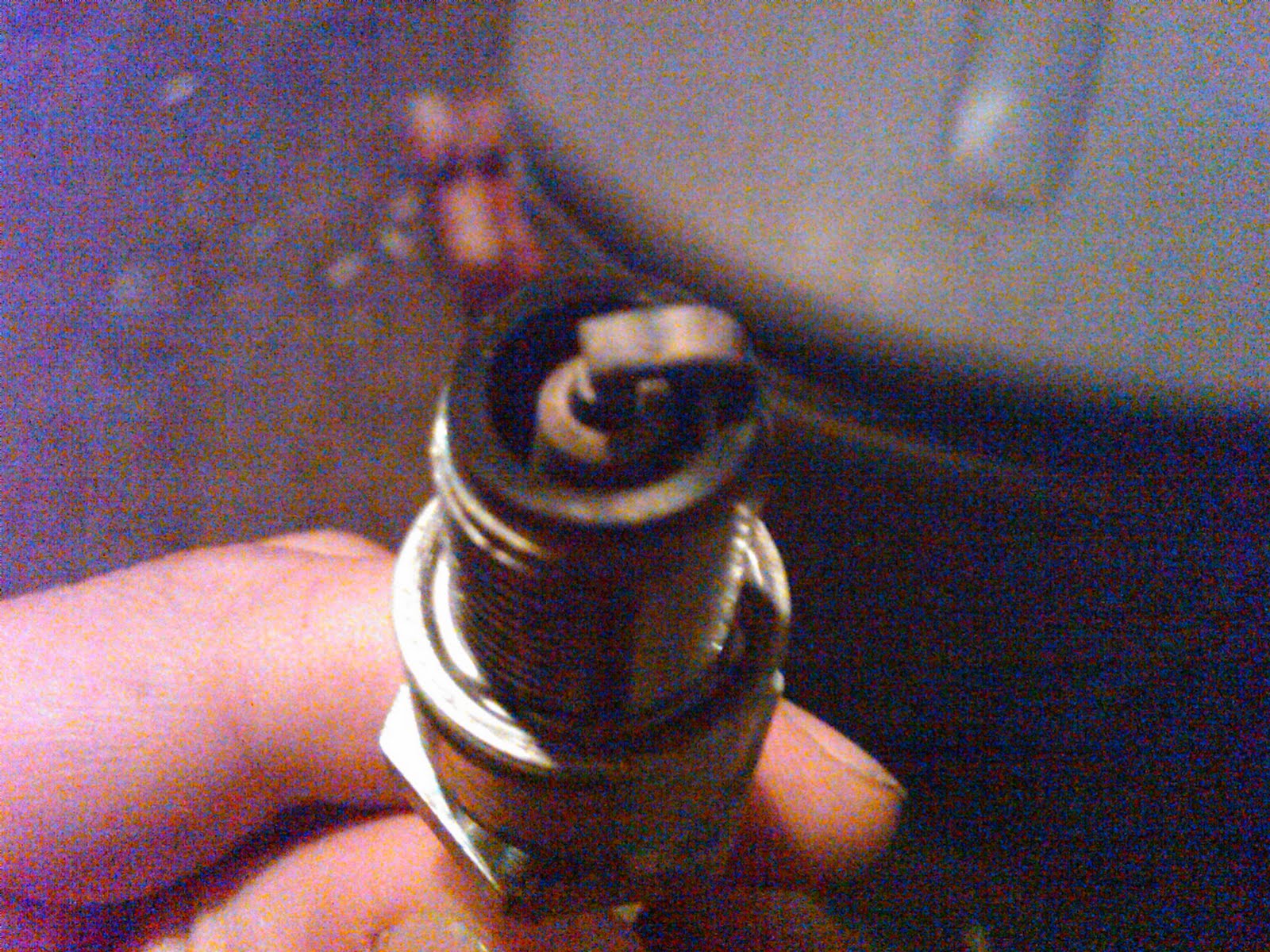

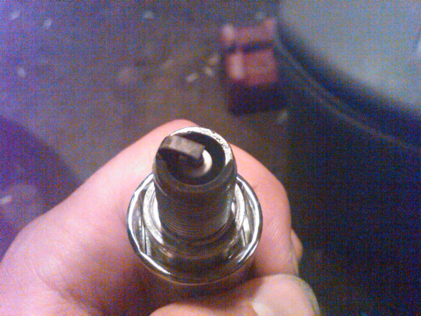

At any rate, it IS a possibility that you may be rich somwhere in your circuits. As the bike warms up, they will become even more rich, and cause bogging, sloggy running or just plain die.. Smoke coming off the motor doesnt seem to suggest this however.. Id take a look at your plugs..maybe post a couple of pics. Plugs seem to be the window through which you can tell alot about whats going on in your combustion chamber..

Pictures of spark plugs to come
