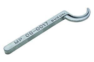

                        You'll probably need the little bucket depressing shim tool.
