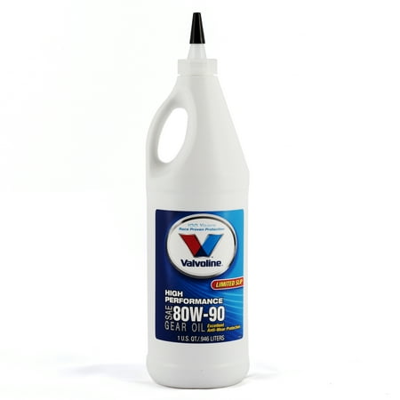

Old thread but thanks for posting this. I got some 90w gear oil at Napa for the last change but it's been about 8K miles and time for another change. I am heading to wal mart for some other stuff and may pick it up there. I remember asking for Hypoid at Napa and getting the deer in the headlight look from the guy behind the counter. The stuff I used did have the GL-5 rating though.
This should work just fine right?
JJ -
I don't remember what the specified replacement frequency is, I just change the gear oils and lube the splines every time I change a rear tire.
