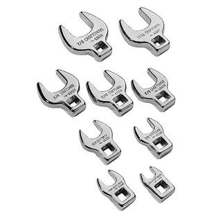

    Also how did you torque those shaft to engine bolts? Manual says 70lb and red loctite... Can't get a socket on them...

    When I did my frame swap on my 80 1000G back in 2010, I lowered my frame over the engine and then installed the swing arm. If I remember right I used crows feet wrenches on my Torque wrench.

            To torque the driveshaft bolts, I use a long high quality box end wrench (sorry, "ring spanner") and tighten them really, really, really damn tight.
            IIRC, the manual calls for new bolts each time, and they come with a red thread locking compound applied. These bolts are highly stressed, so no substitutions.
            I suppose if you really wanted to get the exact correct torque, you could do a little measuring, a little math, and use a spring scale with a wrench. But it's a very high level of torque for an 8mm fastener. Not sure whether a normal open end crowfoot would hold.
            They do make "flare nut" crow foot style sockets...

              Yes, interesting that they were not that tight when I took them out (I cracked them with a standard length ratchet spanner), I don't know if they were messed with before but they had the remnants of the loctite on them.
              I think the manual calls for about 65-70ftlb from memory. I didn't see a call for new bolts, maybe due to stretch, it's an insane amount of torque for that bolt as you say. As much as the rear axle. I'll have a look at that, thanks for the heads up. I'm about to put an order in for some other stock parts (rubber bits) soon.
