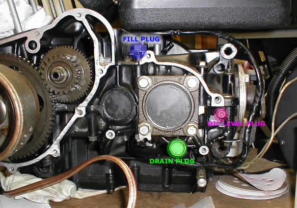

    The following image may prove helpful; a lot of people mistakenly overfill the secondary drive gear oil the first time around.
    Drain, replace drain plug, remove level plug and fill plug, and fill slowly only until oil starts coming out the level plug. Wait until it mostly stops dripping (yes, this is messy; aluminum foil is one good way to make a temporary drip guide to keep it off the exhaust), then replace fill and level plugs.

      Thanks for that quick reply. Actually my question had to do with which stand the bike should be on when setting the level of each chamber. In past, working on many brands/models, I had to always look this up rather than remember,....or try to at least.
      I think the secondary drive box would be done on center stand. It looks like that in your pic. Somehow I think the rear drive is done on the side stand tho.

        OOOOOPS! Sorry. Was so drawn to the bright colorful picture I missed the most important first line. Geezerhood doesn't mix well with ADD.

          That pic is just a dead engine on a workbench, but yes, the bike should be on the centerstand for both gear oil changes.
          The centerstand should be used for all fluid changes and checks, actually.
