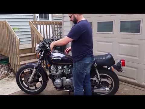

Are you sitting on the bike when you do that? The center stand foot lever is on the left, and the brake lever is on the right. I don't see how you do that.Originally posted by Uncamitzi View PostI do pretty much what Steve does.. One trick I use along with that is leaning a bit forward and bounce on the centerstand lever while holding the front brake. At the highest point I get to, I apply the front brake to keep it from rolling forward, as the front tire grips I rock back on the center stand. Usually takes me two bounces and I'm up. Took me a few times to perfect that move.https://drive.google.com/open?id=0B9zH8w8Civs8ejBJWjdvYi1LNTg&resourcekey=0-hlJp0Yc4K_VN9g7Jyy4KQg&authuser=fussbucket_1%40msn.com&usp=drive_fs

Yeah, I hit the brake just after coming off of the center stand to keep the bike from rolling forward. But getting on the stand? I don't get it.https://drive.google.com/open?id=0B9zH8w8Civs8ejBJWjdvYi1LNTg&resourcekey=0-hlJp0Yc4K_VN9g7Jyy4KQg&authuser=fussbucket_1%40msn.com&usp=drive_fs

No! No! Not sitting on bike. Steve did say something about "lean over bike", but no, not sitting on bike. Stand next to bike. Steve does it facing the bike (but he is a tall guy).Originally posted by jsandidge View PostAre you sitting on the bike when you do that? The center stand foot lever is on the left, and the brake lever is on the right. I don't see how you do that.
I suggest facing forward, but I am concerned about keeping back straight-vertical.
And nothing to do with either brake.

My comment about the brake is referring to this quote. I do it exactly like the guy in the video. Pretty easy even in tennis shoes.Originally posted by Uncamitzi View PostOne trick I use along with that is leaning a bit forward and bounce on the centerstand lever while holding the front brake. At the highest point I get to, I apply the front brake to keep it from rolling forward, as the front tire grips I rock back on the center stand.https://drive.google.com/open?id=0B9zH8w8Civs8ejBJWjdvYi1LNTg&resourcekey=0-hlJp0Yc4K_VN9g7Jyy4KQg&authuser=fussbucket_1%40msn.com&usp=drive_fs

Following the video --
Not a bad show of technique --
But FOR ME -- I use my LEFT FOOT not the right ..
And then as you PUSH DOWN (stand on the center stand lever) Pull Up and BACK with your right hand (shoulder)
The idea is to create distance between your LEFT FOOT and your RIGHT HAND (which is on the seat grab rail)
A simple shoulder shrug will take the bike up - By using the left foot - you get a lot of YOUR WEIGHT behind the pivot point.
Once my bike is back together -- I will video me doing it with the saddlebags ON - it is a bit more difficult but I can still do it.
