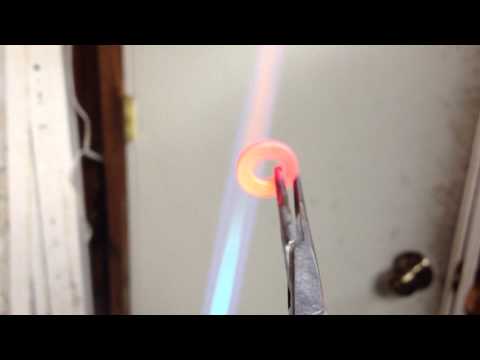

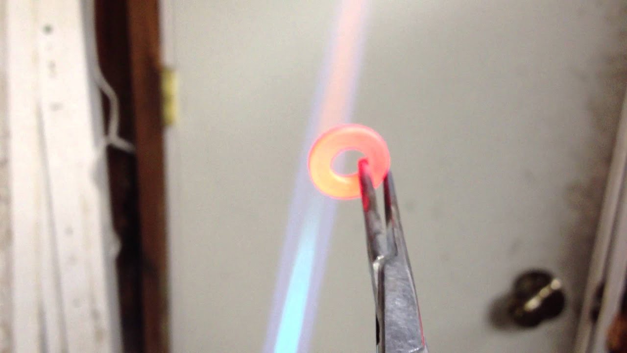

        • eddypeck
          use new crush washers
          I know they're only pennies, but if you're caught out and haven't bought new crush washers and don't want to be held up, heat them with a blow lamp till they glow red hot.
          Let them cool (there's some debate on if the should be left to cool naturally or dropped into water) and they'll be good as new and ready to reuse.
          The heating expands them to their pre-crushed state. Done this for years with old washers if new fitting haven't supplied enough, or I drop one and it rolls away.... or I simply over looked I needed them and new had an issue on fuel lines, brake hose or oil fittings.

              The OE crush washers are plated so I'm not sure heating them red hot is the best solution. Plus, after being used they get a deep groove in them and making the metal soft by annealing won't take that out.
