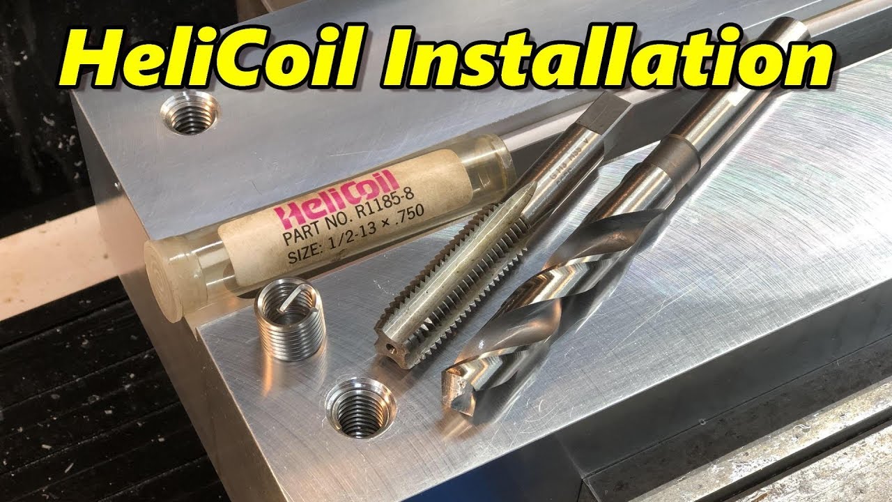

                    • 35811
                    Originally posted by posplayr
                    This video shows the use of a mill to be sure to drill and tap straight. This is the critical element to assure a good job. No freehand work because the insert may wind up tilted in the workpiece.

                        I called 9 machine shops , no one here even does auto machining. Even called 3 different auto parts place, the place they used went out of business . Actually had a plumber at my house working and I asked him, he gave me the name of a diesel repair shop , I called them, they said they didn?t have an M7 helicoil , but if I brought them the part and the coil they would do it. So I?m without a ride until next week.
                          this kind of thing sometimes goes smoother if you show up in person with a 6 pack? just my experience
                            • 35811
                            It's not "auto machining," it's installing a helicoil. Any machine shop can do it (if they want to that is.) Small jobs just don't pay enough to bother maybe? Anyway, don't give up.
