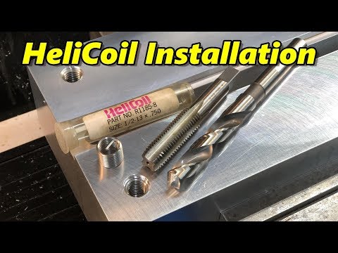

This video shows the use of a mill to be sure to drill and tap straight. This is the critical element to assure a good job. No freehand work because the insert may wind up tilted in the workpiece.Originally posted by posplayr View PostEd

because I don’t have a drill press and I am sure I would drill it crooked.
I called 9 machine shops , no one here even does auto machining. Even called 3 different auto parts place, the place they used went out of business . Actually had a plumber at my house working and I asked him, he gave me the name of a diesel repair shop , I called them, they said they didn’t have an M7 helicoil , but if I brought them the part and the coil they would do it. So I’m without a ride until next week.

It's not "auto machining," it's installing a helicoil. Any machine shop can do it (if they want to that is.) Small jobs just don't pay enough to bother maybe? Anyway, don't give up.Ed
