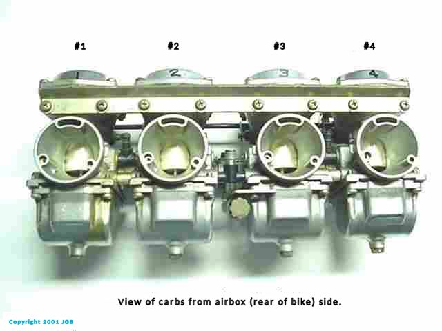

      Is mine CV or VM? Im sorry if this is clueless.
      I apprechiate your reply.
        Should be CV - post a pic of the carbs if you want to be absolutely certain.

          The abbreviation "CV" means constant velocity, a generic term for the general type or style of carbs you have. (CV carbs have vacuum diaphragms)
          The specific carb model series used on your bike is the "BS" series. Sometimes you'll see both abbreviations used interchangeably. They're talking about the same carbs, at least on a GS, but they don't mean the same thing. Sorry. We're a little sloppy about that around here.
          If your carbs look like this, they are BS series CV style carburetors.
