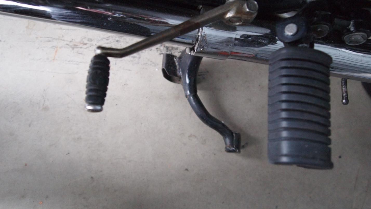

                        CB450S....note the absence of a spring...
                        From cmnsl
                        Last edited by Gorminrider; 03-29-2020, 11:43 AM. Reason: not sure why pic didn't show first time..

                          Just happen to have some examples to crop from my pix...CB450S right side...
