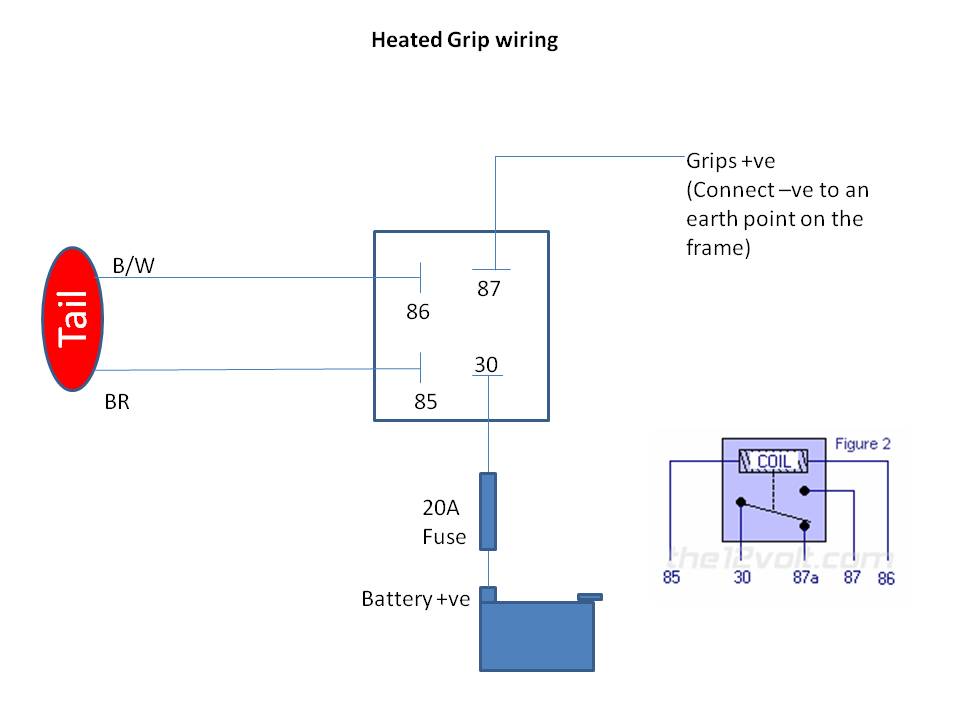

                            Old thread, but occasionally someone runs across them and may need a diagram. Since there was not one posted I thought I'd help out. I had a two-speed fan relay setup in a V8 RX-7 that was very similar.. and very easy to modify the diagram. This uses a three position switch low/off/high.
                            Two automotive SPDT type relays:
                            Assumptions-
                            12 volts comes into the switch.
                            If off, it goes nowhere.
                            If low, high is not energized and it energizes the low relay coil and sends the load to the low input of the heater.
                            If high, low is not energized and it energizes the high relay coil and sends the load to the high input of the heater.

                              I actually wired them like this
                              BW is a ground. I actually picked up the orange wire in the rear light bundle as a switching wire from memory.
                              2nd relay wasn't necessary as the switch can handle even the high current fine.
                              For something more powerful a 2nd relay would protect the switch though. Good diagram.
