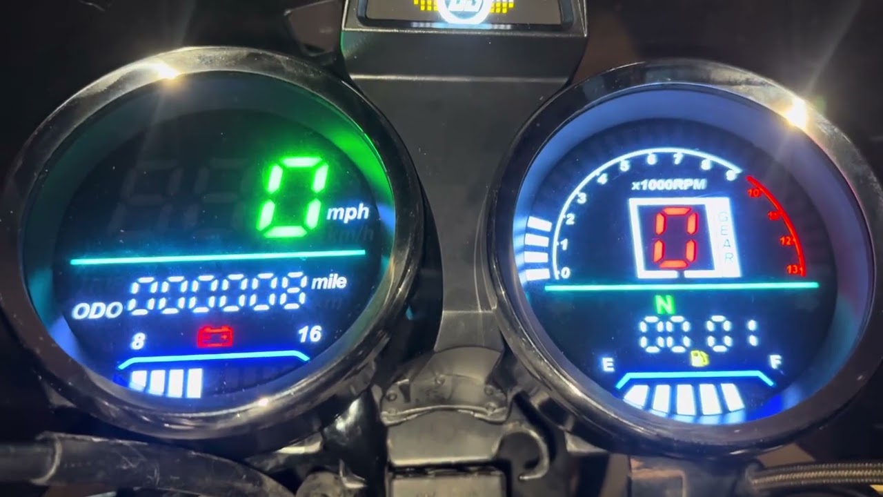

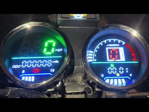

      Well, this pretty much wraps it up. An upgrade? I’m not quite sure. But it is modern and very easy to read all info at a glance. Very bright. Better quality than expected for the low cost. All in all a fairly easy project if you can read a wiring diagram and make good crimps, use a hacksaw and a hammer.

            To be clear: the hacksaw and hammer were for cutting the ears off the digital gauge cluster bracket and for bending the Suzuki gauge cluster bracket. I have a very spiffy crimper from Vintage Connections for the wire work.
              your work looks great! I have to say that getting the angle right is the hardest part of a gauge setup. my 450 tach cable is long gone and hole filled in. i would like to tap into a coil for a solution at some point.
              Also, there is probably a setting on the unit to adjust how it reads the tach. i bet it is set wrong. it has to be a digital pickup inside the pod, so it is prob doubling the signal or something.
                Thank you. As I noted, (or thought I did), the tach is cable driven, as is the speedo. There is only one button on the unit. sort of like older digital clocks in some cars that had 2 buttons to change settings, except, just one button that I muddled through a mixture of short and long presses to scroll around to the things you could change (like KPH/MPH). And of course there are no instructions. There is a mire marked "Tacheometer" [sic] that I left disconnected. I can only imagine that it's meant to attach to a coil, instead of the cable from the valve cover. I'm not really worried about it. I know what a 1200 rpm idle feel/sounds like, and I've rarely ever red-lined the bike. Well there was that ONE time. If you want to read about that, here's the link to my Destroy-Rebuild thread. Destroy-Rebuild 750T
