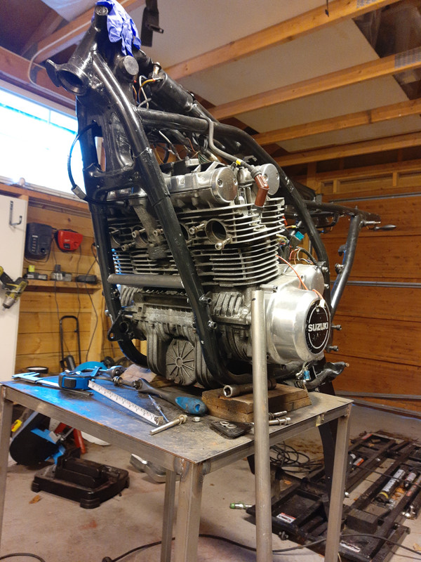

    Hi again, been a few years since I was last on this forum, still haven't finished my gs but hoping to get there now. So tomorrow I'm starting to brace my frame.
    I've been reading this; https://oldskoolsuzuki.info/archives/315
    And I see it's a 60x20 1mm box steel that's recommended on the B C and E bracing, but what if I can't find that? Can i use steel tube instead? Or make a box with 1mm steel sheet?
    I see both boxing and tubing being used online but I don't know about the pros and cons, I'm sure anything is better than nothing at this point but I wanna do it proper when I'm first gonna do it.
    And if anyone is wondering why I'm doing this I'm fitting a sv1000 front fork and a bandit 1200 rear with öhlins shocks so I think it's for the better.
    You can fold those box sections out of sheet. No reason why not. look at the plane of the forces. You could also just use a single thicker plate and get most of the same benefit with a lot less hassle (that's what Suzuki do as stock on where they brace the frame)....

      I used a mixture of round and rectangular tubing when I braced & monoshocked my frame. I can say it definitely reduced the "hinged in the middle" feeling of the flexy stock frame. It's never going to be as stiff as say a modern sportbike frame, but is definitely an improvement over stock.

        I used tube, 16g plate and one piece of tube between the swingarm pivot where I added another engine mount.
        Its a work in progress.

          these are made with 16g plate.

            under the tank.

              another picture.

                Aluminium engine mount, more than 1lb lighter.
                Sorry for the small pictures, I know how to post bigger pics.

                  Thanks for the replies, I think I'll just fold some sheet metal for the box sections B and C and use tubing for the rest.
                  Made the front one today

                        I'm hoping the removal of the stock seat and rear of the frame along with aluminium rear swing arm and a lifepo4 battery pluss removal of any unnecessary stuff is gonna negate whatever little weight is put on by this
