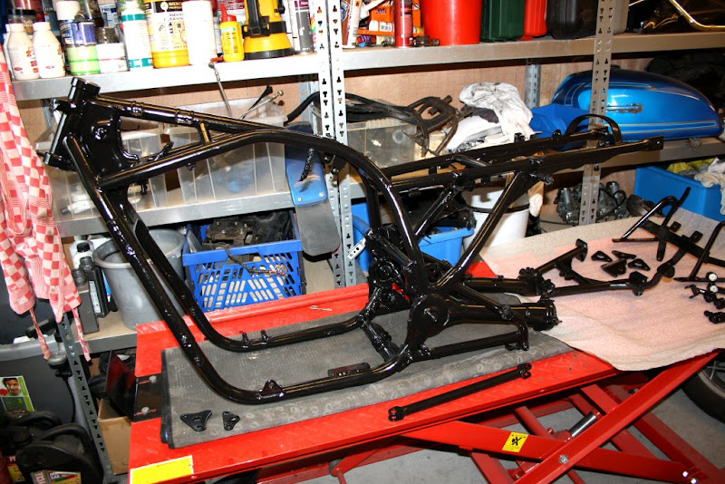

                  Frame came back from the sandblast/coat company, looks good. Its some kind of special paint they also use on boats, very tough. sandblasting all parts, primer and topcoat was $150, not too bad I think.
                  Pictures:

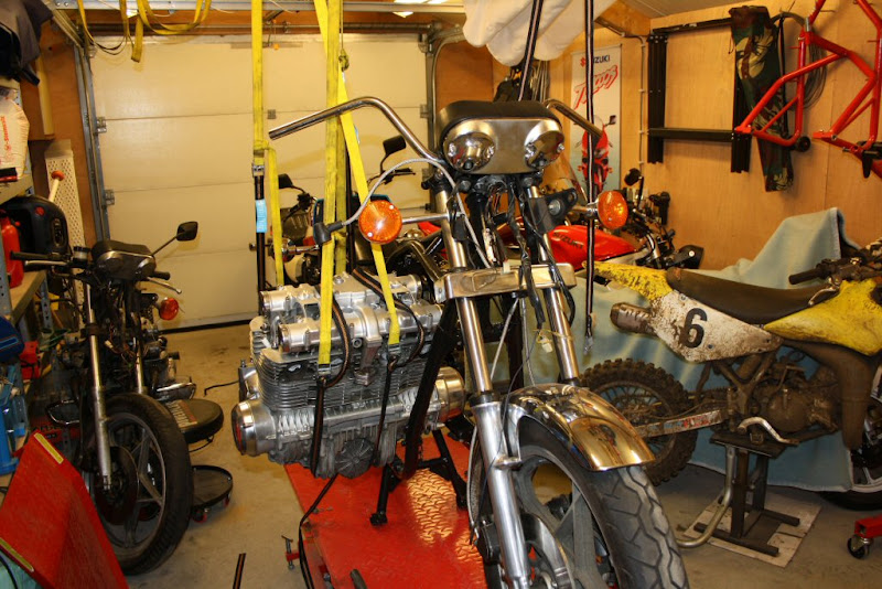

                      Well, im still waiting for some gaskets, but I am already thinking about putting the engine back into the frame...I said thinking, maybe I should say worrying...
                      Any tips on how to join frame and engine without breaking my back AND keep the coating on the frame undamaged?
                      • Digitus

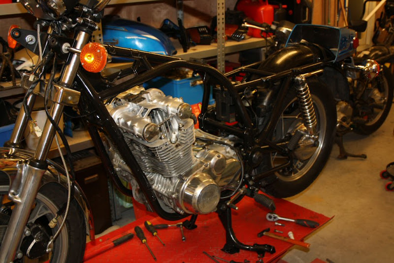

                        Hello all, I managed to do some things on the bike, when it was raining and other activities were put on hold... After much thinking I managed to put the engine back into the frame using straps and a motor lift. It worked great, I had to work slowly and check the clearance a lot, but I got it in without lifting it myself.
                        Just when I thought I was quite a good mechanic I discovered that I forgot the rubber protection sleeve between the engine and the shaft
                        Anyway, long story short: its 3:15 am now, everyone is asleep and finally I got my engine in properly WITH the rubber thingy
                        I just HAD to redo it and get it done before sleep
                        Here's the pics:

                        • 7981GS
                          Looking fantastic! How did you get that final drive to sparkle? Nice.
                              "Lay the bike on the side" seems by far the easiest method.
