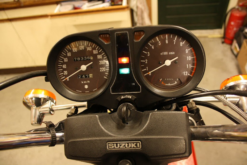

            Soooo, I hooked up the battery and checked ... everything works EXCEPT the neutral, oil pressure and gear indicator. .....bummer.
            Havent got the time to hunt down that problem right now. I assume GI, neutral and oil are all switched to ground, so I suspect a power failure in the clocks somewhere..to be continued
            • Digitus
              I found the problem ! Broken cable that feeds +12V to various bulbs. Details are in the pics. Funny thing is that the rubber protection around the bunch of wires was not damaged ! My guess is the problem came from bending the cable repeatedly and when I took the clocks off the bike the cable was already on the verge of breaking.
