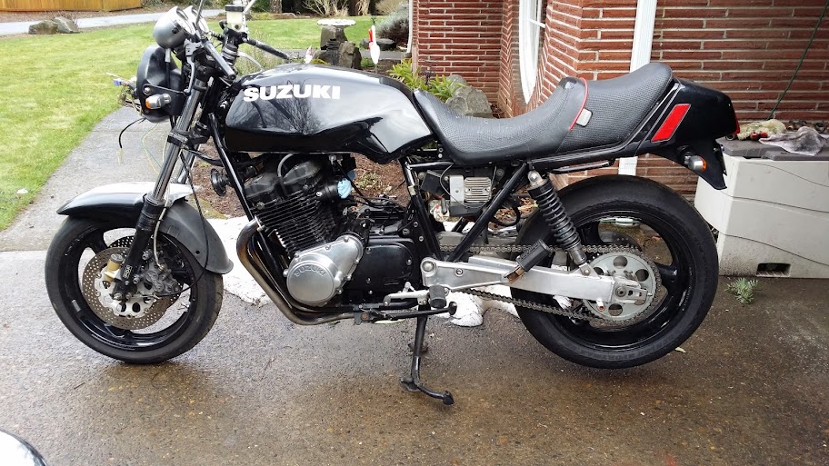

    My project is all over the place in the "Technical" forums, so here's an overview.
    Phase II summary:
    1. 1984 GS1150 motor.
    2. 1995 GSX600 Katana oil cooler.
    3. Mikuni RS38 Race carbs.
    4. K&N pod air filters.
    5. 1992 GSF400 Bandit gauges.
    6. 2003 GSXR750 handlebar controls.
    7. Dyna 2000 ignition system with wires and coils.
    8. SSPB Solid State Power Box.
    9. Series Regulator Rectifier*.
    As the bike sat Summer 2013.
    1984 GS1150 stock motor.
    Motor installed, Bandit cluster mounted.
    Dyna 2000 mounted, Battery raised 3.5".
    1995 GSX600 Katana Oil Cooler installed.
    Adapters fabricated. 16mm GSX banjos to 14mm GS oil ports.
  • CivilRock
    continued...
    Diagnosed and fixed upshift problem.
    Deleted the TSCU. Deleted the CPCU. Deleted all the redundant wiring. Added a SSPB, Added a Series R/R (not pictured yet)
    Added Mikuni RS38 carbs with K&N pods.
    1992 GSF400 Bandit Instrument cluster.
    2003 GSXR750 Handlebar Controls.
    As it sits just now at my office after a great morning commute!

                  No doubt on the dispair. I was sure I bought a basket case motor. After I "tuned" the shifter spring, it's smooth as butter now.
                  The coolest thing right now about it is the obscene sounds that it makes at the carbs. You can hear each huff the motor makes as its pulling air past the clacking flat slides at idle. I'm going to have to figure out how to record the noise somehow.
                  -Kevin

                        I took metal shop in high school and loved it. I bought my MIG welder at Home Depot about 10 years ago for $400, and a racing buddy gave me his Mini-Lathe for FREE if I could figure out how to make some spacers for him. I just like playing around with this stuff in the garage, and I'm amazed at all the uses I've come up with to use both. I use both those tools at least 2-3 times a month. The welding part was easy, but I'm pretty proud of the idea, and my lathe work. So thanks.
                        I don't have an 1150 cooler to measure, but I would guess that this one is about 3 times bigger than the 1150. I was just trying to find something that would work by looking at pictures on Ebay and then looking up corresponding parts with online microfiche for the banjo fittings. This one was $29 shipped with the cooler lines, and every 1150 I looked at was around $200. To be honest, I think the 600 oil cooler is a bit overkill. I'm glad I didn't go for the 750 unit, it's even bigger. Hopefully I'll be glad I did it once I bump the power up to 160HP. The power builders seem to agree that more cooling is better.
                        -Kevin
                        Here's some more pics during the fabrication of those adapters. Oh, and I actually didn't expect this to work. I wasn't sure I could drill into the bolts cleanly or centered. I was pleasantly surprised with the results.
                        I started with a small centering bit, then worked my way up until I got as far as I thought would be safe.
                        Then I used an even bigger bit to "neck" it up closer to the 16mm nut ID, if you look closely, it's not exactly centered on the bolt head:
                        But the important end was perfectly centered, so I was happy.
                        Then I just welded them together.
                        If you look at the far port, you can see that once I add the copper washer it's still not going to work. The bored out 14mm bolt is too long. I ended up taking off about 7mm of the end and carefully cleaned up the threads. While I had them on the bench I filed down the welds and gave them some paint. I'll have to take another picture of the final product.

                        • CivilRock
                          Rob S., Here's how the adapters look in their final resting place. Probably should have let the paint dry a little longer before I installed them. Getting up close to the bike in the sunshine (it's been absent for a while now) I realize how much this bike needs a detail. I haven't even cleaned it in a year. She's not going to win any show awards, but I still love her.
                          If I can sell enough of my old parts for a new seat I'm going to do it. Then I need to get to polishing. All my polish work has faded over the last 9 years. It's time to freshen her up a bit.
