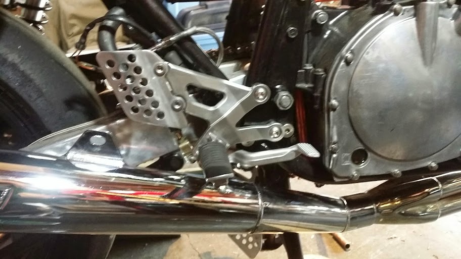

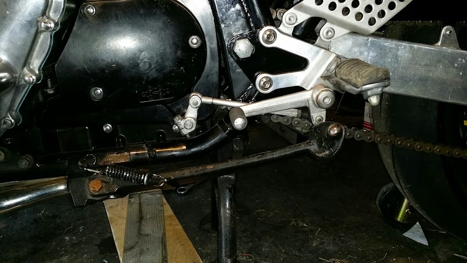

                      Well, successfully mounted my eBay ZX12R rear sets, and now I have a kickstand problem because of it.
                      I also mounted the bottom hole of this one just a little back and it's tilting the whole rearset up a little. I thought that it wouldn't make much difference, or that I wouldn't notice. It's about 3/4" higher than the other side. If I never would have noticed or measured it, I probably wouldn't ever care. Now that I know about it, it's going to bug me! But that's the beauty of working with heavy steel, I can just weld on an extension and redrill/tap the bottom hole.
                      Here's my problem. The kickstand interferes with my toe when I try and put my shoe under the shifter. The whole time I was setting it up, I had the kickstand out of the way. Not sure what I'm going to do to remedy the situation. I don't want the kickstand to drag on the ground. The best solution would be to cut the mounting bracket from the frame and move it back about 8 inches. I was about to remove the center stand as well, because with the extra ride height (added longer shocks) now the chain rubs on the center stand. I should just delete both and lean my bike stuff when I need to ride.

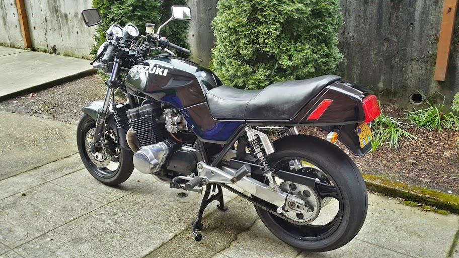

                          • 9387
                          As a fellow 1100EZ owner, I say ditch the centerstand. I bought my Suzi six months ago without one, and I don't miss the extra weight one bit. I bought a cheapo ("Trackside") rear paddock stand for $29.99, and everything is groovy.
                          Now the sidestand, that I would miss. A lot!
                          PS I love your bike! More pics! More pics!
                          • CivilRock
                            Thanks Rob. I'm sending off the seat today to get recovered. Sucks because the weather here is freaking awesome right now. I might be bundling up some towels as a seat. If I knew I wasn't going to buy another Corbin, I wouldn't have sold the one I had!
                            Here's a pic for you. I have stands. I'm just a center stand kind of guy. But now that I raised the ride height in the rear, the bike sits better on the side stand. Before it was kind of sketchy.
                            I found the front stand buried in my shed and bought a rear for $50 off craigslist.
                            Oh, and I am going to ditch the center stand. I'll just keep the rear stand handy in the garage. I can't wait to see how much weight I shed with these rearsets. The massive aluminum passenger peg mounts are huge.
                            -Kevin

                              I filled, drilled, tapped, and re-cut the plate twice on the right side, and no less than 5 times on the left side before I got it where I wanted.
                              I thought I was going to nail it the first try. I don't need no stinkin' plexiglass facsimiles. Whoa, was I wrong. The biggest problem is that the rearsets are not symmetrical. The V-shape is, and they look the same, but upon closer examination, the left peg is 1/2" higher. This was driving me cray-cray until I figured it out.
                              Pegs are with in 1/8" height now, and look like almost the same mounting height if you don't look at both sides at the same time. Which will only happen on the internet.
                              I'm going to just add a little spacer at the kickstand hinge to drop the kickstand arm down about 1" when it's in it's retracted position. That gives me enough room to get my toe under the shift lever, and still keep the kickstand high enough to keep from scraping. And yes Rob S., I ditched the center stand.

                              • MK3Brent
                                #30
                                Kevin,
                                I too ran into a kick-stand issue.
                                My purposed solution is to either A. Cut off the mounting point and relocate the kickstand farther to the FRONT to totally clear the assembly, or 2. Buy something like this:
                                Simply clamp it around the lower tube, and position it in a place that won't interfere.
                                Could even put it on the right side to be English.
