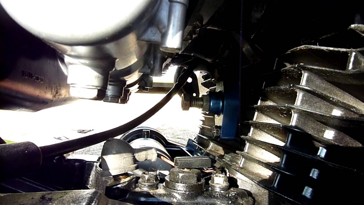

    Grimly - this bike came from the hot part of the US and the PO stuck this massive oil cooler on it:
    which is twice as big as standard. You might be forgiven for thinking there were temperature problems and indeed I do wonder what the bottom end might be like. There were some rumbles which can be heard here at around 2:24 - it doesn't sound too good:
    Leave a comment:

    Can't view youtube where I'm at right now but if it ran that is good.
    The bad thing is it isn't always a good indicator if an engine is worth investing in a major repair....a worn out Japanese 4 motorcycle engine will run seemingly well even with low compression. It isn't until you get on the road and give it the beans when you discover an anemic, tired engine.
    64k miles isn't a gigantic amount unless it was mostly slow city miles. But the wear on the cam makes me wonder what the condition of the bottom end is.
