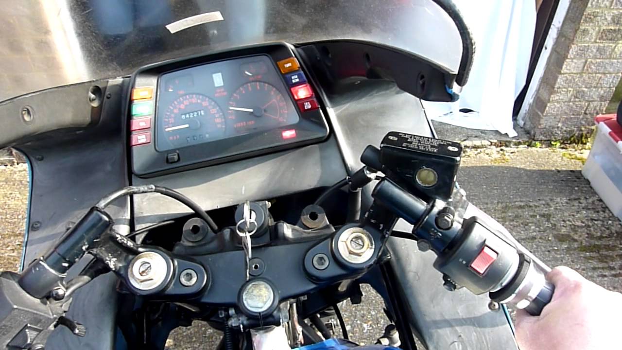

    Motor Dies When Throttle Opened
    I posted this is the carb section:
    and I have since checked one of the fuel levels in the no. 1 float bowl by jamming a piece of plastic tubing up the drain plug. It seems that the fuel level is pretty near to the top of the bowl, so lack of fuel being able to get up the main jet can't be the reason it dies when the throttle is opened.
    See it in action here:
    Air box is sealed and throttle slides are working.
    Help!!
    Leave a comment:
    replied
    Video shows air filter sitting on top of the airbox, not inside. That could be part of the running problem...
