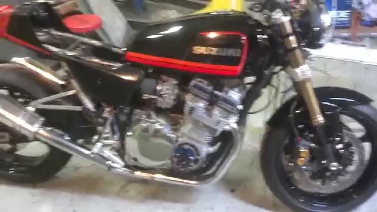

      I've been playing around with the wiring a little bit. I had to see how the gauge and new LED head and tail light work. I'm going to try to start on the battery box this weekend. The big battery in the video is just for testing.

        Looks nice!
        • TiiMuch
          Absolutely great looking bike I think. You've inspired me and maybe others who are looking to upgrade the GS suspension.
          I see some of my questions are answered in your first post, thanks.
          What kind of dash is that in the last video?
