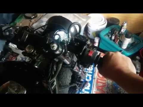

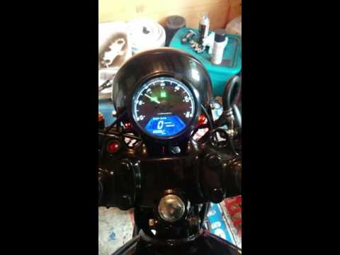

            Can anyone help me out?
            I am looking for a positive connection for the RPM to complete the connection of my digital gauge. Does anyone know?
              #51
              Depends on the unit you have, but I have my Trail Tech Vapor tach lead connected to the '-' side of one of the coils. You can also try the '+' side, it seems to give a weaker, but less noisy signal.

                  #53
                  On my gs550, I added a chi-bay electronic tach/speedo unit.
                  To get the tach to work, I took the (-) side of the coil and tapped to the tach signal wire on the gauge. where the wire for the (-) coil and tach signal wire connected, I tee'd a 10k ohm 1/4 resistor to a 12v wire and everything started working.

                    Mark
                    I have a ChiBay unit, and can't get it to work in any way shape or form. I can get it to somewhat work by wrapping the signal wire around one of the spark plug wires.

                    Can you post some pics or a diagram? This seems to be very interesting, thanks.

                          #57
                          schematic is half way down the page on the above link. only difference was i connected to ONLY one of my coils.

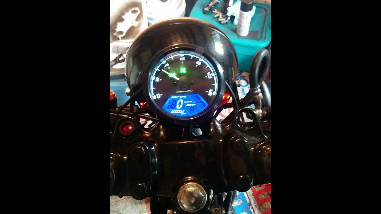

                            #58
                            Soon Steve, soon.
                            Thanks for the link frankenwabbit
                            Found a good signal and here it is:

                              #59
                              oh...btw...if you don't have a fuel sender in your gas tank and want that fuel level gauge to stop blinking...just connect the fuel sensor wire on the gauge to ground....if that doesn't work...you connect the fuel sensor wire to a resistor (forgot the value) and then to ground. Something like that.
