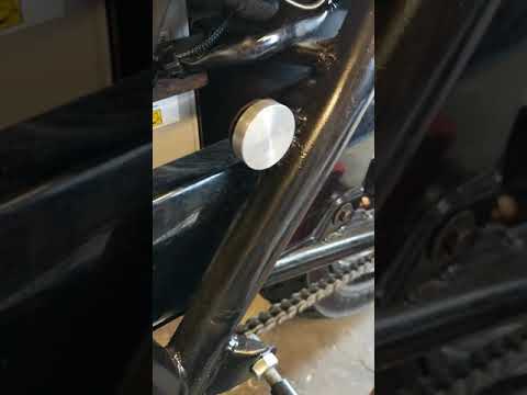

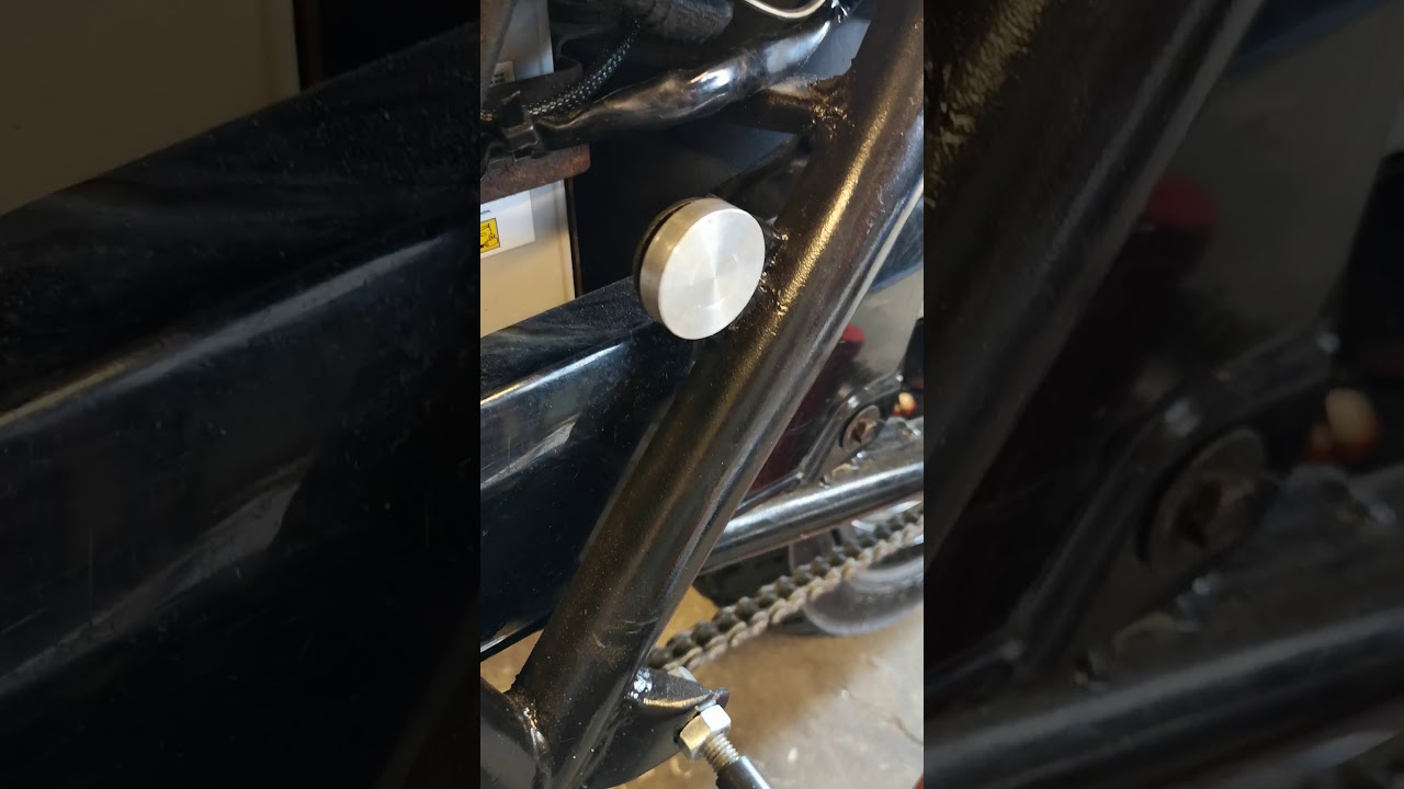

                  Also got the first sidecover done (not with the final paint..). I've had those perforated stainless steel sheets laying around forever and finally got around to use them. I wanted to be able to remove them easily and for that reason I've kept the original mountingpoints on the frame.
                  First I fired up the lathe and made a "push-button" for the bottom mountingpoint:
                  Then I made a cardboard template and cut the perforated steel into a loose fit:
                  P?ska by Lars Krogh-Stea, on Flickr
                  I'll line the edge with an edge protection profile like this:
                  96520-K1367-Kantenschutzprofile-Edge-protection-profiles-Form-C by Lars Krogh-Stea, on Flickr
                  I used the same profile to line the backingplate for the licenceplate:
                  I shaped two pices of the same perforated steel to the back of the sidecover and pop riveted them in place, also drillet and riveted the "pushbutton" fastener:
                  Did a quick "paint-job" and mounted the cover. The fit is prettyr tight and there is very little room for vibration. I'll go over the edges and fine trim them when i get the edgeprotection profiles:
                  Next weekend it's time to fit he speedomoter, and then I'll get to drive it home. That will hopefully speed up the process significantly
