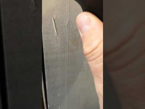

                                Made the tray for the m-unit and ignition today. Will drill holes for cables and for strips to fasten it later.
