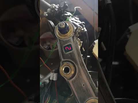

    And I made a little video of the updated gear indicator:
