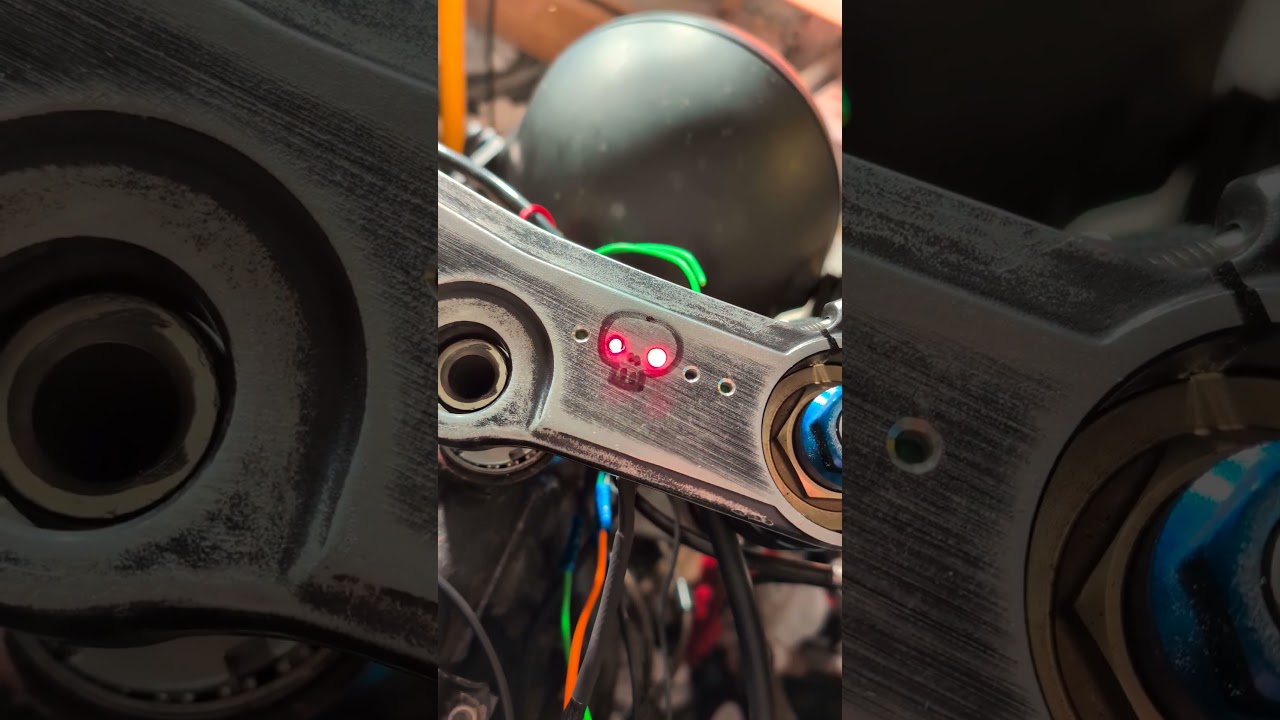

    I soldered the LEDs to a protoboard with 510Ohm resistors in series (as the LEDs are 3V max /20 mAh). The black ground wire is looped here for testing, but the final version has ground wires. One in common for turn signal/high beam, and one to ground the oil light. I bought quality LEDs, but they can break so i made the oil pressure light (skull) reduntant and with separate resistors.

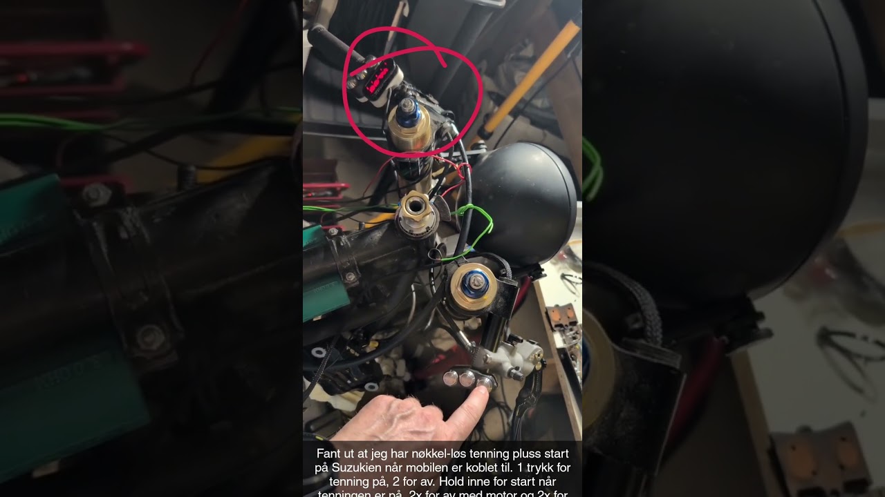

      The switches are reconfigured:
      Left is:
      1. Lights. Short press - blink high beam, longer press - switch high/low, even longer - turn off.
      2. Turn Left. Short press - blink 3x, longer press - blink continously. Stop with short press.
      3. Turn Right. Press both 2 and 3 for hazard lights
      Right is:
      1. Start. Read below.
      2. Horn (Can also be used to configure M-unit, but I use my phone for that)
      3. Motogadget Mini operation (configuring and switching between infoscreens)
      The keyless start is configured like this:
      • Approach the bike with bluetooth turned on and mo.ride app (service) running on your phone. The phone will connect to the bike and a (turn)-light signal will tell you it's connected.
      • Push start x1 to turn on bike. Motogadget Mini display shows startup animation.
      • Use starter button to start your engine. Light turns on automatically. Light can be turned on an off by holding light button
      • Press Start x2 to stop engine.
      • Press Start 2x again to turn off ignition
      In the video I'm testing the system without starter relay connected.
      The display can be configured for both horizontal and vertical use.
