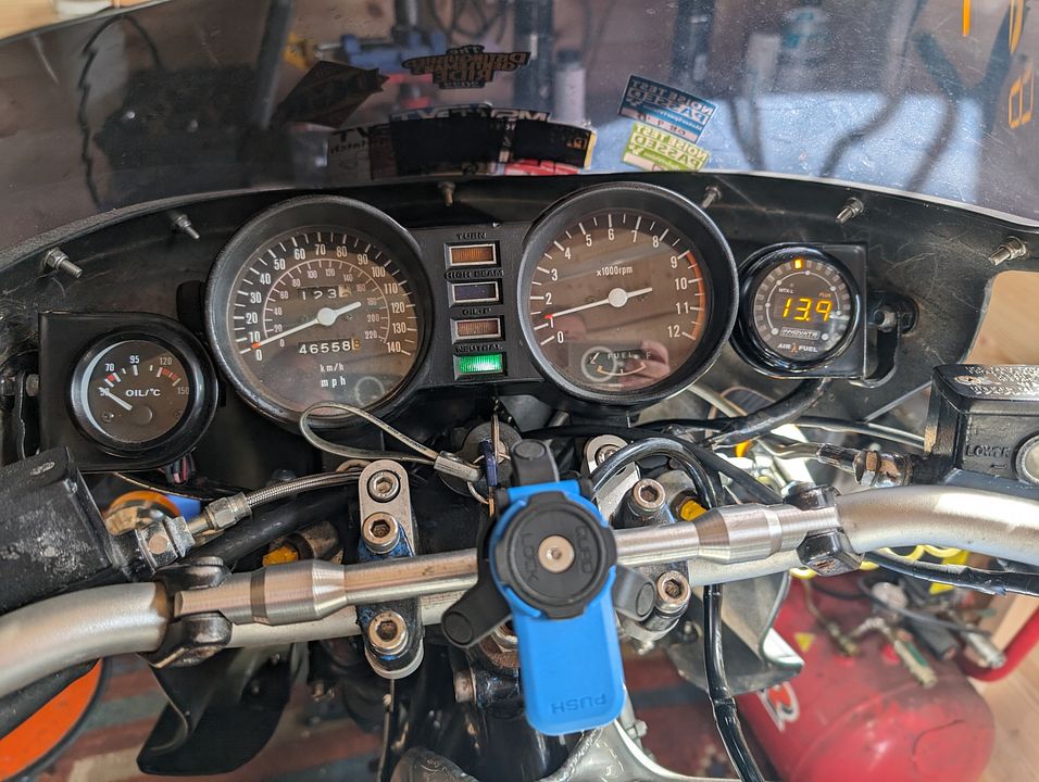

    I bought a very cheap eBay oil temp gauge that came with it's own sensor, you will need to check the thread pitch as they are all slightly different to the Suzuki pitch. My bike was a 1000 S that had been re-framed using a GS1100 so the engine had the oil temp sensor next to the oil pressure switch but since I have now added an oil cooler the adapter has the space for a oil temp sensor, I used the sensor that came with the gauge but had to source an adapter from eBay to match the thread pitch and it all works very well. You will need to take a switched live from the clocks for the temp gauge and run a signal wire down to the sender, I used a pink wire to match the original wiring, and that is about it. The photo below shows the set up on the engine.
    I see. Not really relatable to my 1981 750 engine then..
    BTW; No chicken strips on those tyres Do you have a video of yourself on track?

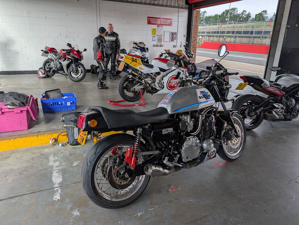

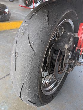

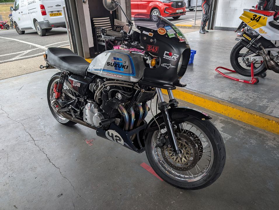

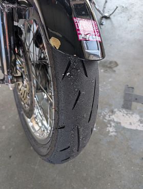

    I figured that I haven't posted any photos of the bike in a while as it has certainly changed over the years
    This is at Brands Hatch on a track day

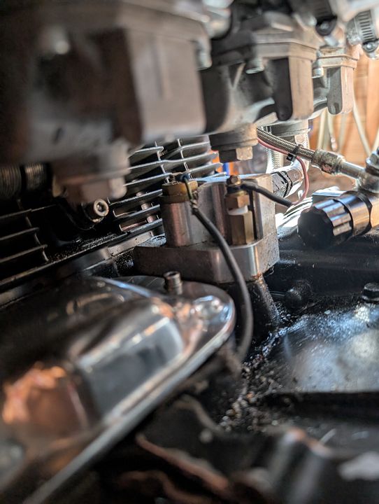

    I see you have an oil temp gauge. May I ask what route you went to get the temperature reading?

    Hi, nice work

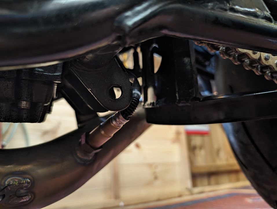

    So, a little while back I mentioned that I was going to fit a wide band lambda and gauge to the bike which has been done. The reason for this was to set up the 33mm smoothbores and before I get into that this is the location of the sensor.
    The 33's came with 140 mains with standard 17.5 pilots and the jet needle set on 5, this is the needle as high as it could be, the seller assured me the set up run perfectly on his bike...
    As you can see from the main body of this thread I have a 1085 Wiseco pistons, ported inlet and exhaust, Pop Y cams and a Ti Racefit exhaust and it ran like a pig.
    1st thing I did was drop the mains to 137 and drop the jet needle to position 1, it was better but choked up below 4000rpm. It also was very flat until the absolute top of the rev range which is no good.
    To cut a very long process into a reasonable time frame, the changing of mains to 135 then 132.5 then finally 128.5 has given me a nice 1/2 to full throttle response and AFR reading.
    There are stories that 33's won't idle properly then also transition between 1/4 and 1/2 throttle has a flat spot, well mine idle really nicely and pull from idle right up the range. But, it took time to get them to where I wanted them.
    As we all know the 33's idle on the air screws, I set those up using colour tune and checked the AFR reading on the gauge, once this was stable I moved the jet needle up and down trying to get a smooth transition from closed throttle to 1/2 throttle. This area is controlled by the pilot jet and the AFR was leaning off so I changed the jets from 17.5 to 22.5, I was trying to reduce the height of the jet needle so the mid range was not to rich to early during transition between pilot and main. With the bigger pilots the idle to 1/4 throttle was massively improved also with the Jet needle in position 3 the transition between 1/4 to 3/4 and full throttle is also greatly improved. I will drop the jet needle down one more just to see if it's better or worse just to be sure I have tried everything.
    Below is a picture of the AFR when the bike idling of the choke but not up to temp, Stoich is 14.7 but with these old bikes 13.8ish is fine for idle. I don't have a picture for obvious reasons but here in the UK they love a 50mph road and when the bike is cruising at 50 the AFR is hovering around 14.7 which is spot on. On WOT the AFR is up to 12.7 so that is also good enough for 45 year old carbs on a 53 year old bike.
    Please also bare in mind that if you try what I have done wide band lambdas were developed for fuel injection so when used with carbs the reading will not be stable all the time, I have 4 33mm smoothbores that are older than my children and the readings are there or there about 95% of the time, don't fret if the gauge moves by a couple of points from time to time, compared to fuel injection carbs are basically 4 bucket pouring fuel into an 8 valve dinosaur, but a very nice dinosaur none the less.
