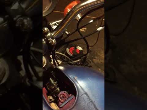

Got the bike started tonight but it's pouring oil profusely from the upper left cam cover. When I started it first I didn't realize the cam cover bolts were loose, so I sequence tightened them but it's still pouring oil.

Here's the bike as she stands, waiting for some needle bearings and race for the swing arm so I can put the rear wheel

It still runs runs and is a little more refined, I replaced the bearings on the swing arm, broke the bleeder screw on the rear caliper then destroyed the threads trying to tap it out, there’s a used caliper in the mail now. I discovered my front right caliper is leaking from the piston area. My kick starter doesn’t won’t engage, and the shifter is not as smooth, for example when you push down into first it just kind of sticks there and doesn’t spring back until you barely tap up on it.
I bought a nice new stator, after hooking it up I realized the previous owner had not connected the rectifier and stator properly. Also, I have no fuses, which I didn’t even think was possible but there’s nothing there. I’ve melted two starter buttons, and think my bike is a very good candidate for an m-unit. The bike looks almost completely stock except the v&h and pods. The original turn signals look great and the new seat cover is very close to OG.
So basically I’m running around trying to put out fires everywhere on the bike, however I do believe I’m going to have some fun riding this Spring, otherwise I’m going to throw it in the river!
