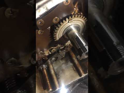

                            So, I finally got around to playing with the shifter and what I gather is when I up shift there?s not enough pressure from the return spring to put back into its original place without physically moving it with your foot, then it clicks into place. However, it does function normally when downshifting, there?s enough spring pressure to put it back into its original place on the meshed gears.
                            here?s a video, you can see it when I up shift, it just hangs there.
                            • jibledso
                              #119
                              I noticed one end of the spring is shorter than the other, the top one where it pivots. I’m starting to wonder if that is affecting the pressure of the spring, or it’s not catching the pivot on the back of the shifter arm.
                              if you notice in the video when I up shift the top of the spring where it pivots does not move away from the pivoting point, unlike the bottom one that does move down and returns the meshed gears back into place, ready to shift again.
                              Does it make a difference how you put the spring on the pivot? Should you do it with the shifter arm aligned with the other teeth?
                              136A4CAC-2C11-4D1C-A73F-128C22065FB6.jpg It

                                #120
                                Btw, it goes into all the gears, just takes a little tlc with the upshifts
