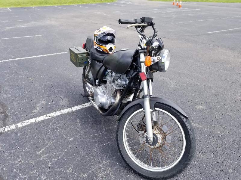

    welcome. Love those ammo can saddle bags.

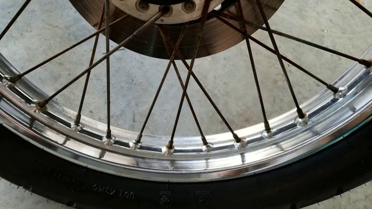

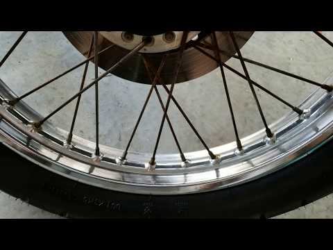

          A little rust removal the old fashoned way =)

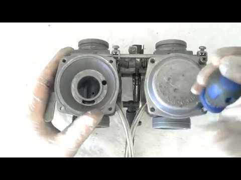

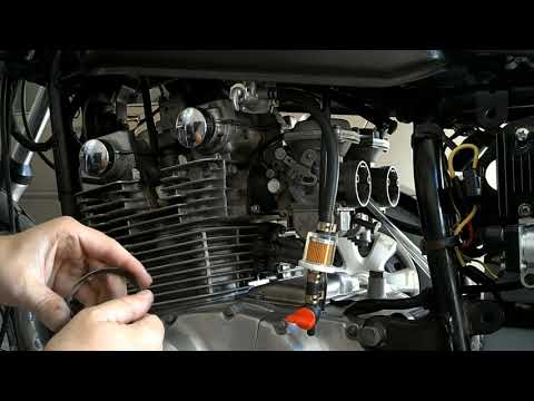

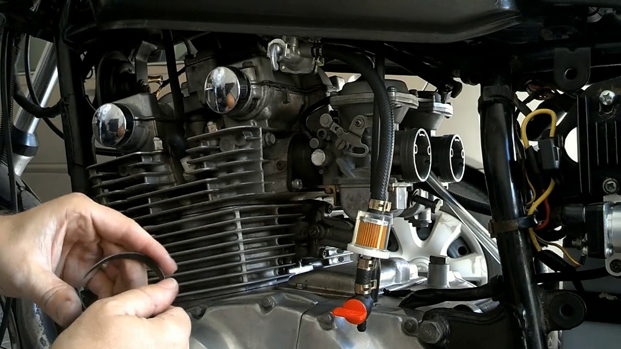

            Time-lapse of Carburetor rebuild
              Time-lapse of Intake Boots & Carburetors install

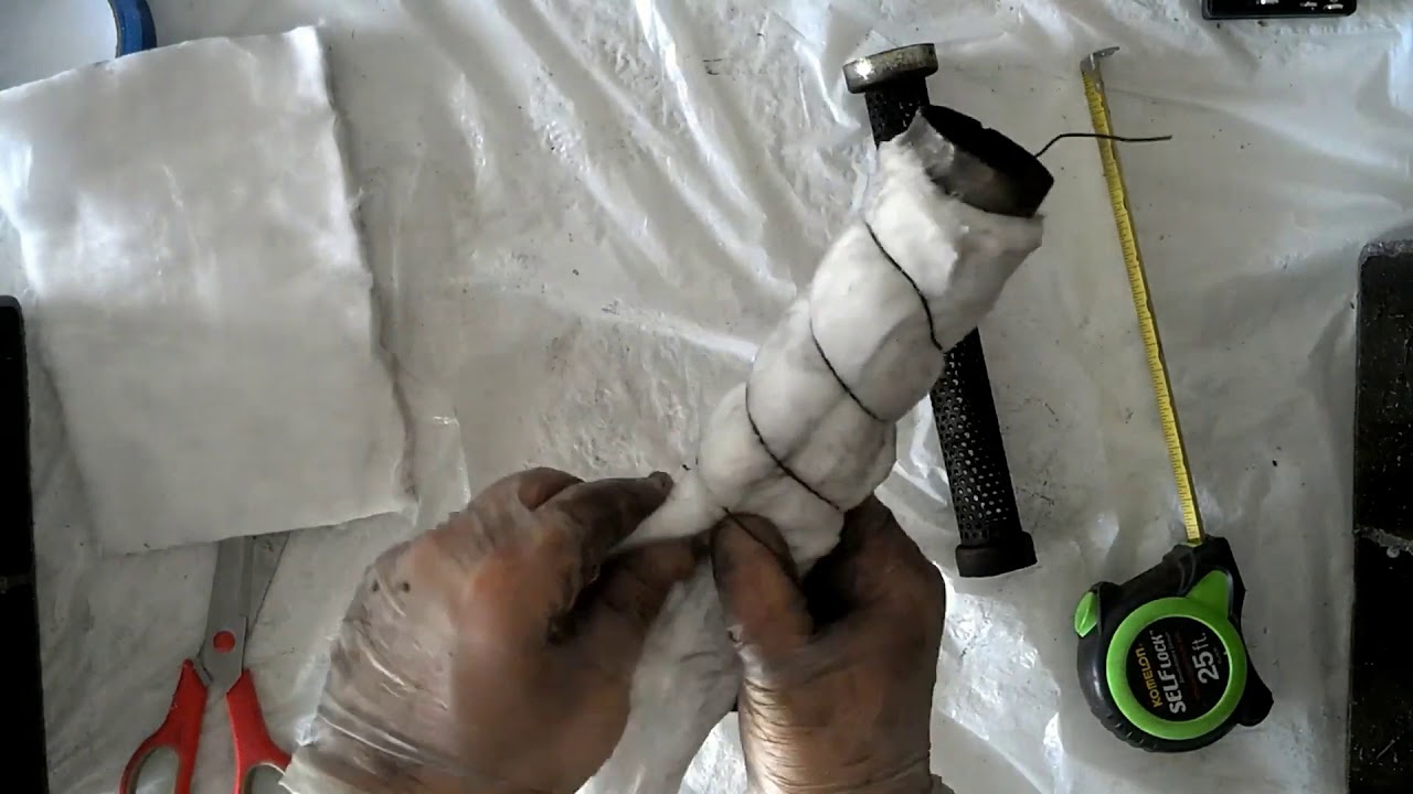

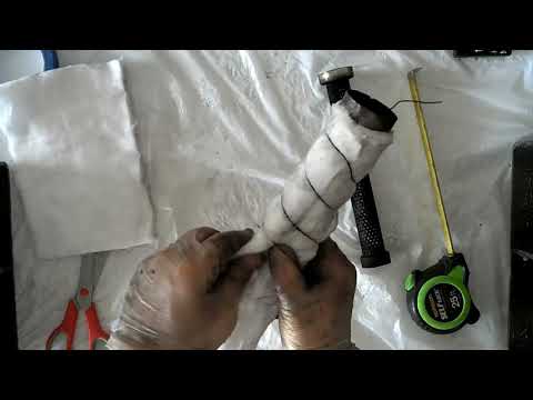

                EMGO Shorty Mufflers: Repacking
                I think I might go back and double up the thickness of the ceramic fiber filler.
                After repacking, the audible pitch of the mufflers went to a lower rumble, but was still as loud as before =\
                EDIT: I did double up the packing material, and it now has a very 'dry' tone. no decrease in sound volume though.

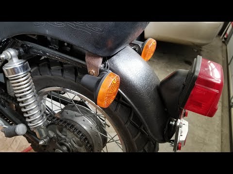

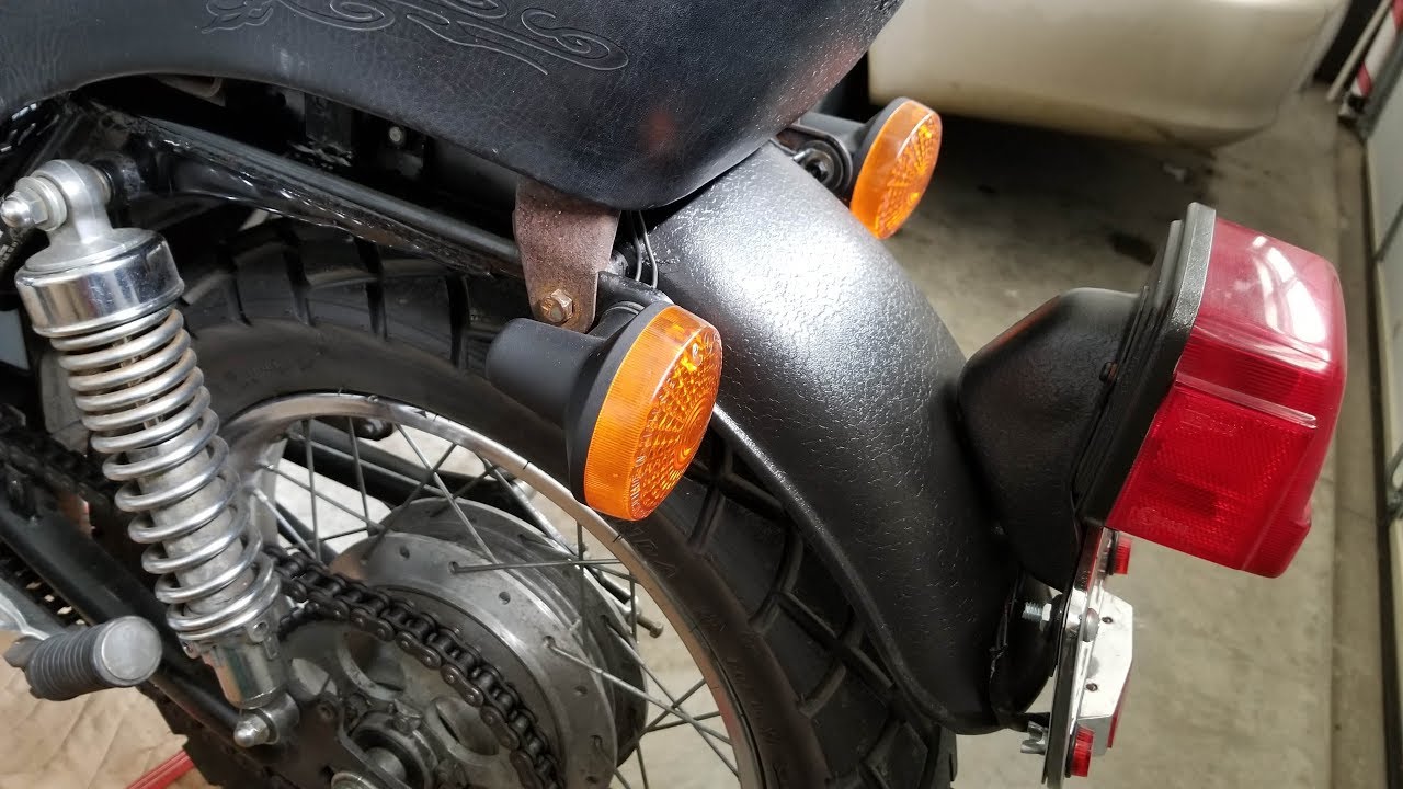

                  Shorten & paint blinkers time-lapse
                  This is just a time-lapse of how i shortened and painted my blinkers (directional lights).
