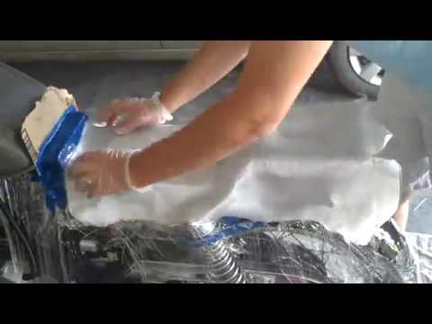

          Time-lapse of seat fiberglass work
          WARNING!!! REALLY LONG VIDEO!!!
