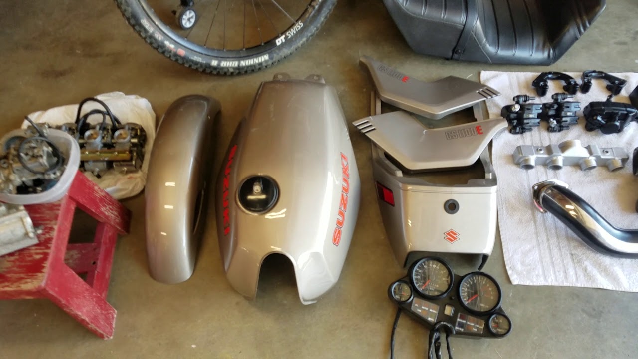

      Well it's a unicycle but making progress, I put the original wheel on it since the EPM is a work in progress with no tire. Nice to have it starting to look like a bike again.
      Tom

        Put on the side covers and emblems, oooh ahhhh...

            Thanks Steve. I spent a long time on the stainless and chrome header/muffler today. I used barkeeper's friend and red (brown?) Scotchbrite, regardless if it's that or baking soda or whatever else, it is mainly elbow grease. It took a good 3 hours, once I did part of the small pipe I was energized to finish up. I was considering Jet Hot or Cera Kote which I still may do someday, but wanted to get it decent and see how it runs before sinking a bunch of $ into these parts. There are some blemishes but overall I'm very happy that they could be brought to this condition, considering the level of tarnish.
            I used some diluted muriatic acid on the rust at the welds and flanges, which worked great. I still have rust in the crook of the pipe I may try to get at, and then perhaps some brush-on silver high heat paint. Gotta check those welds for any leaks too, and if so, get them sealed up.

                        I fitted the exhaust, mounting flanges were bent so I straightened as best I could, pretty close. I have new gaskets. I always find installing 4 of them to be a juggling act. I think I used some masking tape in the past to hold in place then pulled out when loosely mounted. I need gaskets for the 3 bolt round flanges, will measure and see if they are a standard size. Hope so.

                          I got the little rubber grommets for the headlight bracket so I put the front end on, but I forgot one of the little air fitting shrouds that I painted up, d'oh! Oh well quick to fix that. I have to support with the hoist, because the side and center stand are still being powder coated. The original wheels are on for rolling around, while the EPMs are being stripped and bead blasted. Found a wheel shop that does it for $30 each, what a deal. I should have stands and wheels next week. I'm fabricating the forward side cover mount for one side, it was cut off to allow the big S&S air cleaner that I won't use, and with the smaller air filter I will be able to put the side cover on.
                          I also got my Earl's brake lines so I will get those together this weekend. That will leave just a few things to do and buy.
                          I wonder if anyone would want to trade my cut down seat for a stock one. I don't mind the look but I'm 6'3" and it is too low.

                                The oil cooler is huge! It's an 18 row, 12" x 6" Earl's with the feed coming from the filter cover. I don't know why that was used rather than running lines from the two bolts on the front of the engine, but the cover is custom engineered (Lockhart or Kerker perhaps) so I suppose there's a decent reason. The cooler doesn't hinder the steering or suspension and it's sort of badass so I'll mount it. There's no thermostat, maybe good to add? I won't be riding WFO across a salt flat in August. It must've worked but I wonder how well. We shall see. I'm not going to ride this thing very hard, too old and am mainly into bikes for casual rides and restoration activities these days.
                                I was thinking of rebuilding the original Keihin but ditched that idea after reading up on it. Plus there was a little bourbon related accident in the garage and I lost the main jet somewhere, and said F it - I went ahead and ordered a Mikuni HSR42 as that was highly recommended by several online. I will have the two adapters, one to mount to the turbo and the other part of the carb kit for mounting the air cleaner assembly. I'll get the round 5.5" chrome round filter unit, it's common, inexpensive, fits with my side cover, and is what came with the kit originally. I will use my push/pull (pull pull?) throttle on the Mikuni if all goes to plan.
                                I am going to roll the dice on the turbo after a chat with the seller who said it had been rebuilt, and with a guy at Roto-master who said if it turns and doesn't leak oil, it should be good. Rebuild would be an opportunity to have it really cleaned and polished but it's not bad after some careful polishing on my own.
                                In the end if it has any problems like bad oil seals or turbo malfunction I'll just fix them then.
