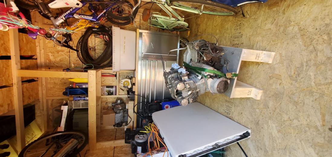

        Is the engine in the frame? I got methods but i need to SEE whats what to accurately post. Throw up a picture. Got a key? igninion and harness intact? If carbs are rebuilt throw them on and fire it off outside so the oil smoke doesnt choke you out.
          Motor is out of frame right now. My daily rider (currently down with head gasket needed) I the exact same bike so might try pulling one out and put this motor in its frame. Everything would be there
            Here is the motor as it sits now.
            The wife and I stripped the bike at the guy's house and loaded the entire thing in the back of the Honda pilot (save dragging a trailer).
            Wiring harness looks intact. Have a spare ignition set in my box of parts and everything else short of a fuel tank and seat.
            And yes, that is another gs750 motor in the background on the workbench.

              ok...as it sets pull the plugs and do a compression check. Then bring each jug to TDC on a compresson stroke and do a leak down test. These will give a decent enough report on compression and condition of rings and valves. hook jumper cables to the car and negative to the engine block. tap starter motor cable stud with the positive to crank it over.
