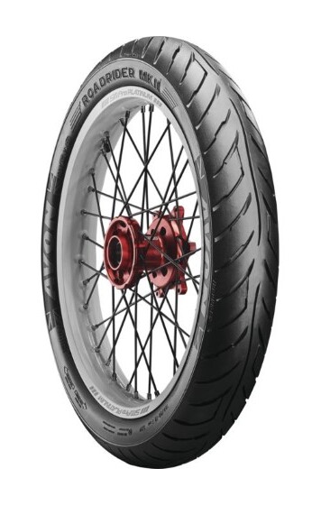

                      Is Avon truly discontinuing the Roadrider, or just moving the manufacturing location? I still see them available for purchase.
                        It's... murky.
                        The Avon Tyre factory in England is set to close by the end of 2023, or may already be closed.
                        Last time I bought a set of made in England Avon motorcycle tyres (for my FJ-09), in 2021, both turned out to be defective. I only found out later that the factory was closing. Make of that what you will.
                        Avon's tyre business was purchased by Cooper in 1997, and in turn Cooper was swallowed up by Goodyear in 2021.
                        There's some generic happy but extremely vague blather from Goodyear (published in March 2023) in this European market article about continuing production of the Avon brand, but it doesn't say where (which usually means China...).
                        Avon Tyres, one of the motorcycle industry’s longest-established tire brands, will receive a fresh focus as part of the wider Goodyear group of brands. Having incorporated Avon into its family in 2022, Goodyear is looking ahead to the future with a reinvigorated approach to the Avon brand. Now sitting alongside the Dunlop brand in Europe, the ...
                        However, on the WIkipedia page for Goodyear, the only mention of motorcycle tires is Montlu?on​, France.
                        If you poke around, it would appear that US stocks of Avon Tyres are very spotty and thin -- click "Part Numbers" here and you'll see that many sizes are out of stock, low stock, or discontinued:
                        Shop RevZilla for your Avon Roadrider Mk II Tires today! Free Shipping, Lowest Price Guaranteed & Top of the Line Expert Service.
                        My guess would be that, at best, Goodyear is still in the process of moving Avon motorcycle tyre production from England to France. In the happy-crappy press release above, they say "more focused", which is MBA-speak code for discontinuing stuff. They do mention the RoadRider MKII will continue. How long it might take for French tires to trickle into the US, if ever, is of course, unknown.
                        Or, they might also be moving Avon motorcycle tyre production to China and not France. That would be a shame, but many other brands have done so.
                        I suppose the Avon brand could just abandon the US market, or switch the US to the Goodyear brand, or something along those lines.
                        Time will tell, I guess.
