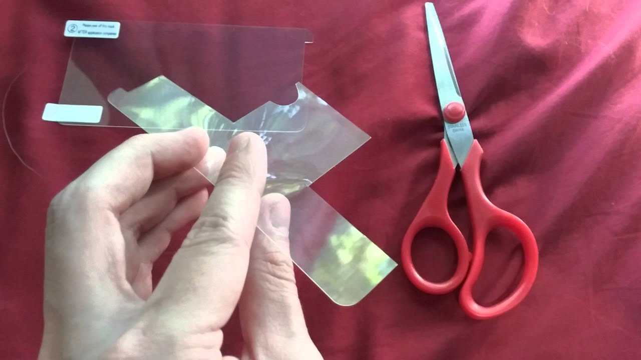

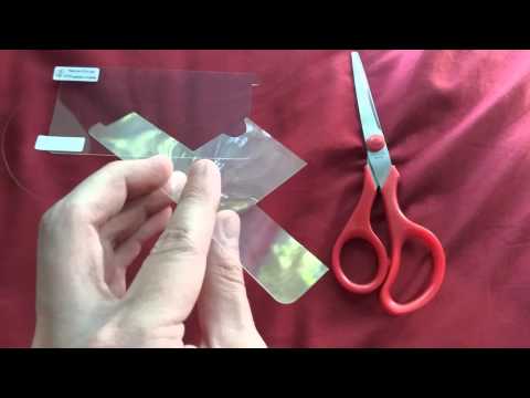

              I've also read or heard of using a piece of 35mm film. (Remember the stuff we used to use to record our precious memories before smartphones), cut it hook-shaped and sweep it in, around and up around between the seal and the inner tube.
              This video has the same idea using cell phone screen protector. Not my video. I've never tried this.
