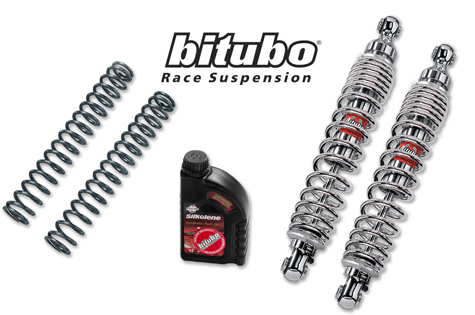

                  Bitubo shocks, race proven technology;
                  they all have selectable rebound presets, (top of the range, also have compression-damping adj.) and are fully rebuildable.
                  They are not as renowed as Holins, only because mgmt. does not invest as much in ads, but can assure you, they ride sweet...
                  Also come in chrome.

                    Originally posted by Lorenzo
                    http://www.wwag.com/step/800/112500.jpg
                    Bitubo shocks, race proven technology...
                    Thanks. I'll look into them.
                    Anyone else have experience with them, or this type of wheel hop?
