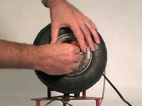

                              My beads experience on Goldwings
                              Over the course of nearly 100,000 miles on my old 1996 GL1500 Goldwing I used balance beads in the tires.
                              They WORK - simple enough . But HOW they work is of some note:
                              Tires CAN wear unevenly and the beads adjust they balance every time you get rolling to the place they NEED to be.
                              That promotes EVEN tire wear and longevity.
                              So - they are not only easier to use for wheel balance ; they are somewhat arguably better -
                              Now on my Goldwing I use Centramatics - (even easier to use as they fasten to the wheel rather than in the tire)
                              But the idea is the same --
                              Here is a short video to demonstrate concept --
                              <strong>
