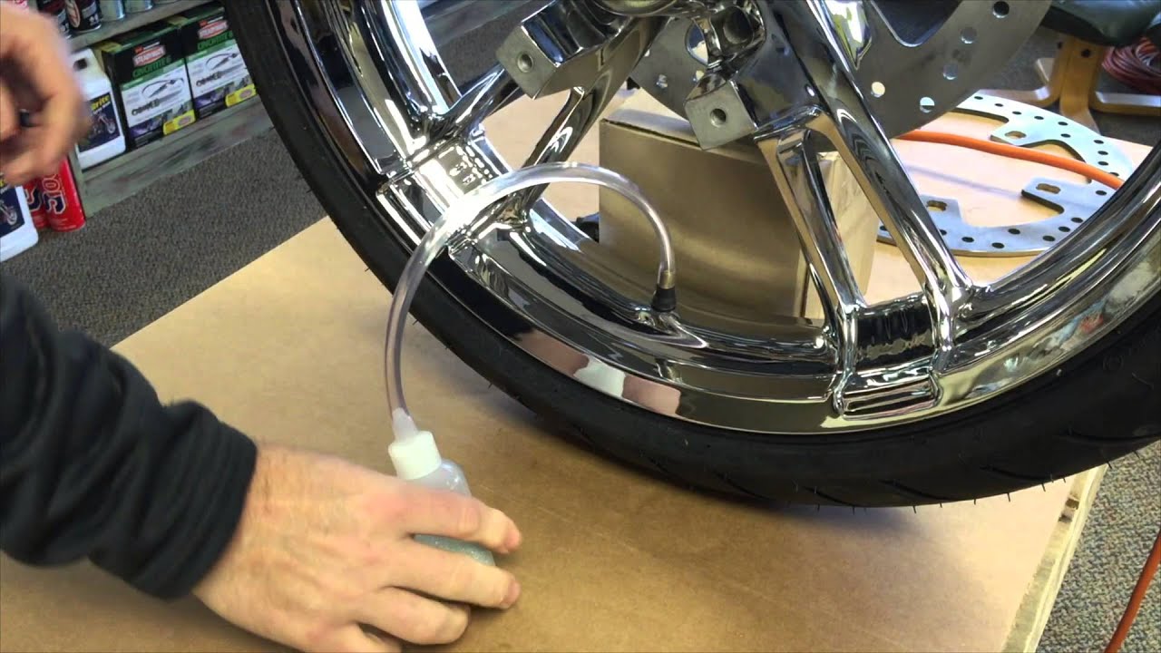

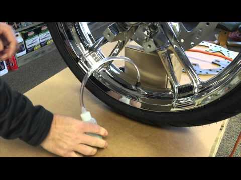

                        Found this video that demonstrates the use of a vibrating engraver to load the balancing beads into the tire. I tried it using a super cheap vibrating engraver without the point installed, and it worked reasonably quickly.

                          I use them and they work fine as long as you go slow and dont pile them up in the funnel/hose/whatever. My 8yr old daughter put them in the front tire pretty much by herself. They went into the tube, however, not straight into the tire.
                          Pushed the 550 over 90mph with no vibration issues. 1oz in front, 2oz in back. I forget the brand but they were abt $15 on ebay. Dont usually get a lot of slab time so I cant comment on touring use.
