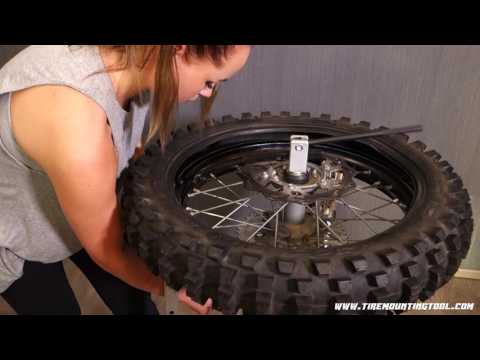

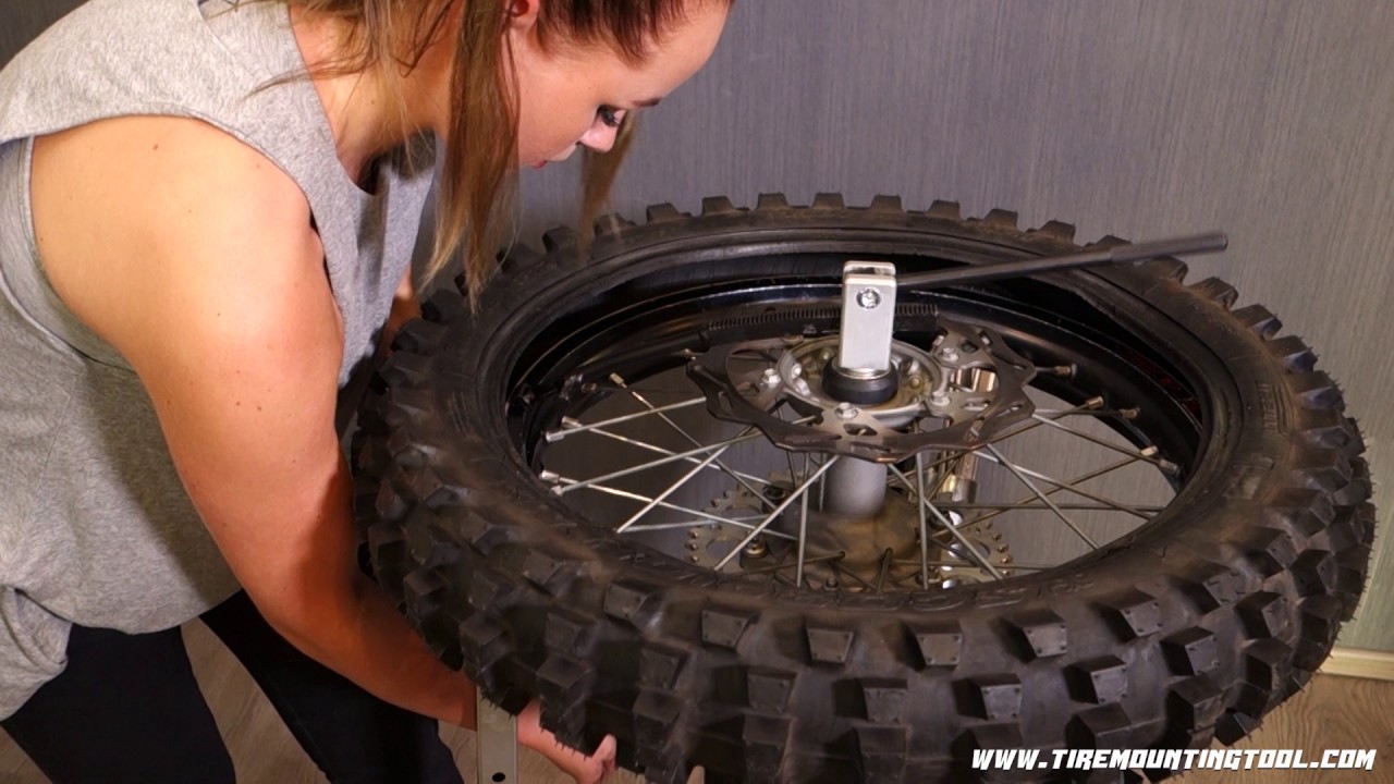

              Had some trouble changing dirt bike tires yesterday. Its been my experience that dirt bike tires with narrow rims are the worst. Don?t change tires often so I watched some videos for tips.
              Came across this video for the macho types that have trouble changing tires. Enjoy.
                Wow, That is a pretty slick machine. She made it look easy. I changed my own tires for the first time a couple of weeks ago. I gotta say it was not as bad as I thought it would be. It's funny such a simple thing can feel so satisfying.

                  This is tool is nice, takes up no garage space and you dont need to be a linebacker to work it. I found a place nearby that does it for $25 mnt and bal. Its not worth my time to mess with it for that. 2 x 4's and tire jack's?.....
                    Originally posted by jabcb
                    It looks like a nice piece of equipment, but at $349USD plus shipping it is priced about $300 more than it is worth to me. All it amounts to is a better stand to hold the wheel than using a 5 gallon bucket or garbage can. The little lever for getting the tire on the rim is nice, but I can do the same, with the same effort, with a tire iron. Having a positive hold down for getting the first side of the tire off the rim would be nice, though. Makes me think I should just work up a pin style holder for one of my existing work stands.

                                I'm sure she has done that many times to make it look so easy, but I try to avoid doing dirt bike tires as much as possible and I have a real tire machine. The tire she is removing is too pliable to have been used on the rims for a season or two. I hate doing them even with the machine. The sidewalls don't give like they were in the video. The side walls turn to rock. I've had some so bad I almost broke out my cutting disk and my machine is made for truck and car tires.
