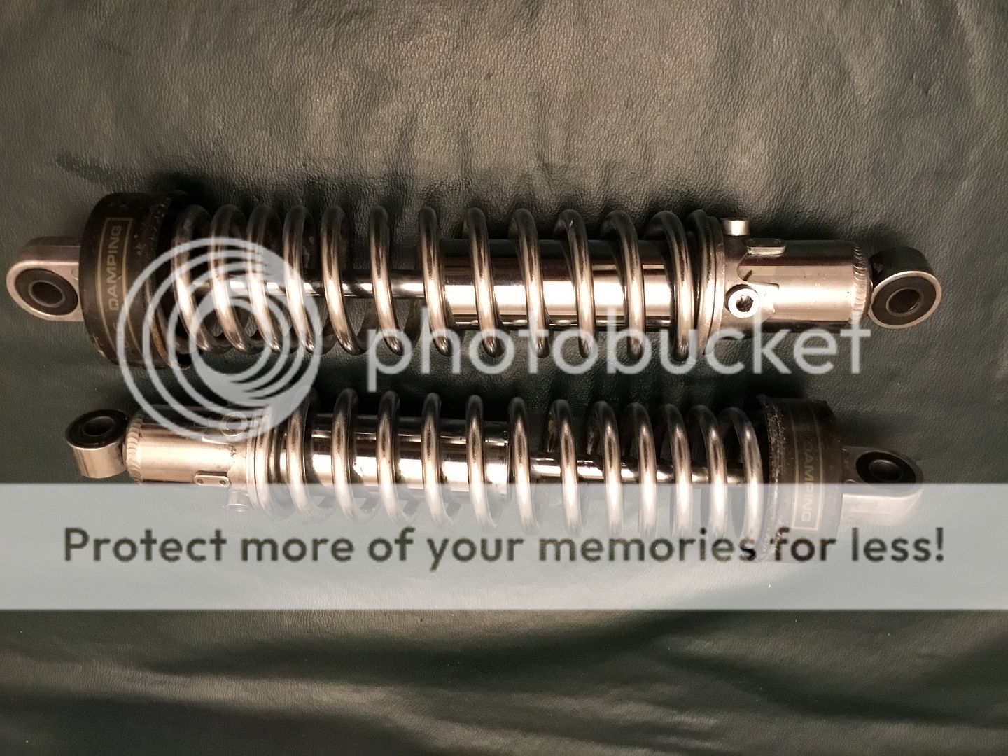

                        I don?t know that much about shocks but I have aNIB set of piggyback style for a GS 1100E.D9E588C8-99B7-4EF6-B730-7242093A46B4.jpg
