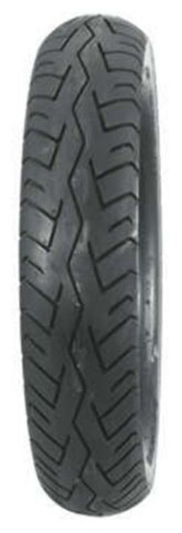

                      The Bridgestone BT-45 might be a good middle ground. It's a fantastic, modern tire that works very well, but the tread is sort of more "busy" than some other later tires, so maybe it won't be as offensive to your eyes? Again, I honestly don't quite understand why this bugs you, so this might or might not be what you have in mind.
