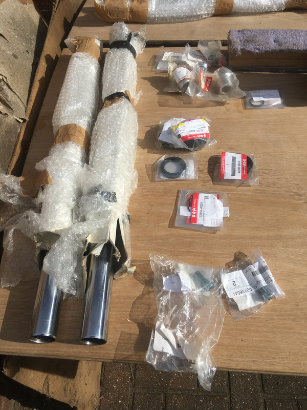

    Well, its finally going to happen.
    After 10 years of sitting unloved in the back of the garage the GS1000ET is top of the list to sort for 2019. First up is the front forks. The tubes are pitted, seals have blown depositing oil all over the brakes and front wheel. All the NOS parts are secured....
    The issue for me is the fork oil. What the heck do you do? Manual gives quantity and weight of oil but the local bike shops dont supply fork oil as in weight. Only fork oil.
    So what do people do nowadays?
    Cheers SB

        Seriously, fork oil is one of the tune-up variables.
        I don't see springs in your parts layout on the table. Hope you are not going to re-use the stock items?
        Check into replacements from Sonic Springs, unless you have a vendor over there that sells straight-rate springs.
        Depending on your gravitational attraction and riding style, something in the .95 to 1.0 spring rate would probably work, then add the proper amount of 10w fork oil and enjoy the ride.

            As for the springs, I will measure the length and see if they are within spec. If they are I will re-use them as she was handling like a dream before. If they are out of spec then I will have to source new springs but I have no idea where I would start looking. I will cross that bridge when I get there. (probably Wednesday if I can get the right oil.)
            Don't forget that the ET model had air suspension plus the oil.
            Let the work commence.
